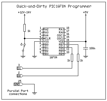

then i came over an simple serial programer for it (the atached gif)
It shod work for the PIC16LF84A but wod it work for the PIC18LF2455
PIC18LF2455 has in circuit programing whith 2 pins
I want to have these on an euro bord so ii wod have an simple 4 pin conector that i can program it thru.

About your programmer: you need at least 5 pin's not, four and if your PIC supports ICSP and your software supports the chip, there is no problem programming it.

the programer (in the first post) can program any chip that has ICSP.right?
So it cod program the PIC16F88 and PIC18F252.right?

Yes, paralel type programers will program *any* PIC with ICSP. Your software has to support it as well.
