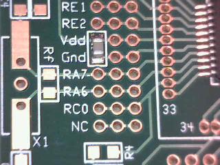

If Osc in pin decoupled to ground by 0.1uF how does the oscillator to work? Or, is it that either crystal or external RC oscillator ? Even the 44pin demo board has the same schematic around RA7.
It is external RC.
I don't have an 18 pin board to refer to, but I do have a 44 pin one.
The 44 pin demo board has a TQFP 16F887 PIC on board. As standard, the OSC pins, RA6/OSC2/CLKOUT (pin31) & RA7/OSC1/CLKIN (pin30), section of the board remain unpopulated. You can use INTOSC without adding anything, or add components (R/C, crystal & caps, or resonator) to use RC LP XT HS etc.
See attached image.
Again, without having a board to hand, I could speculate that the 18 pin board's clock section is probably unpopulated as standard, since the bundled 16F648A has INTOSC...hope someone who has one could chip in & confirm.

It is external RC.
See attached image.
Regards.
Many thanks for the clarification. In the schematic, they should have shown dotted line to avoid confusion. i too had the 44 pin board, but didn't watch it keenly.

In previous MCHP schematics, there are headings within the notes section, which dictate "Items labelled with XXX are unpopulated." or something similar.
Guess this schematic hasn't been revised yet.....
