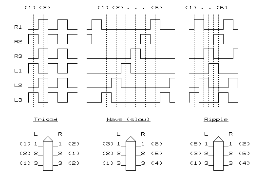

I was really trying to get to the ripple gait. This look smuch better with 6 legs.
I can see a sequence in the attached pic. However is the sequence for each leg up, forward, down, back?
for example in the attached pic
(1) L3 up,forward,down,back
(2) R1 up,forward,down,back
(3) L2 up,forward,down,back
(4) R3 up,forward,down,back
(5) L1 up,forward,down,back
(6) R2 up,forward,down,back
This all makes sense but it seems that one leg is always having to drag the others. Is this right?

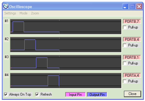

Ok how do I send a pulse to the servo before the previous pulse has completed in pic basic?
start:
ServoOut leg1servo1, 10
ServoOut leg2servo1, 10
I want to send pulses as per the diagram in my previous post.
Regards - Paul
You can't, not in picbasic at least. You also can't just send a single position pulse and expect the servo to keep it, the position signals have to be repeated 20 times a second. With 6 servos and sending the pulses in sequence as you have to with the basic code you'll be wasting about 70% of the processing resources of the chip as it will spend the bulk majority of it's time in a delay loop for each pulse. The project you havein mind is above the complexity that is possible using a basic language. You need a multi channel software PWM that is interrupt driven from a timer and more routines for the software phase timing of the position the legs need to be in for a proper walking motion.
