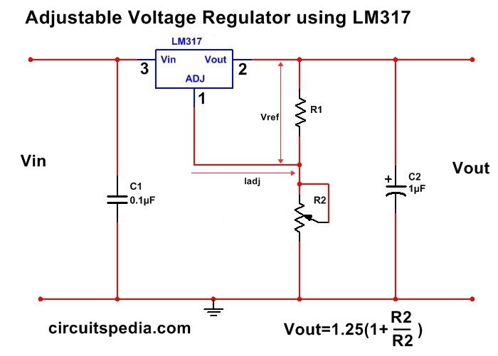

You could take an adapter and "hang" off it several linear / adjustable regulators.
For the fixed voltages just calculate the two R's needed. Calculation in datasheet.
For adjustable replace one R with a pot -
I would fuse each supply, and pay attention, in datasheet, to bypassing requirements.
You also have to determine heat sink requirements -
Regards, Dana.

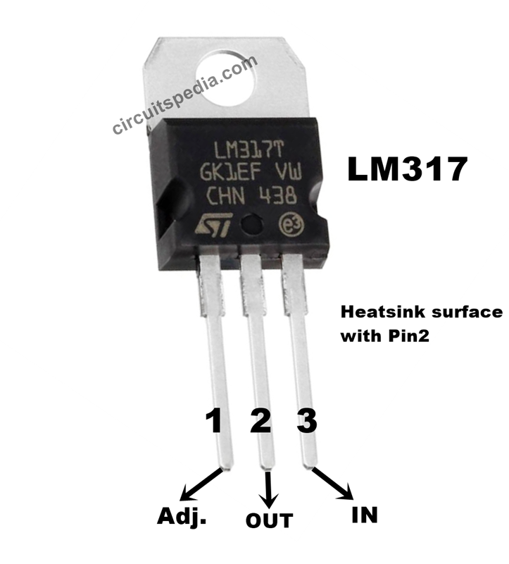

For the lower amperage devices, the LM317 regulator suggested by danadak is a good choice.
They are cheap and nearly bullet-proof.
See the price of LM338K ? Wow. Glad I saved a dozen "pulls" way back when...
I can't see s snow globe using 2.2A either, are you sure about that current? The LM317 is a good regulator, but should have at least a small heatsink on it. Heat from the LM317 will depend on the input/output voltage difference as well as the current draw, so keep that voltage difference small if possible (3 to 5 volts).

Hola danadak
circuitspedia.com could require some serious proof reading.
