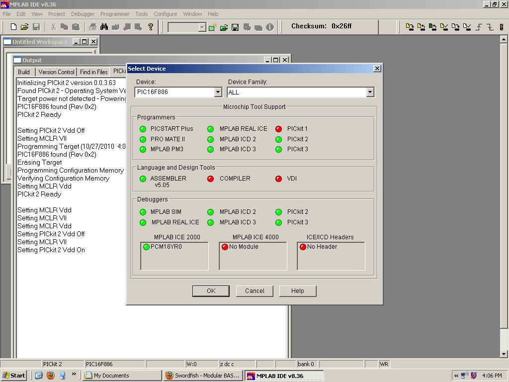

OK, I ended up getting a demo board with a smaller chip on it, 16F886, now my pickit programmer is reading and writing ok! but I accidentally erased the test program on the chip,, I have tried to up load the Led blink tests on port B, but it does not seem to be working? Its hard to tell if im compiling it properly or what i'v noticed slight variations in the code examples, but they should still all work the same right?
could these little red light s be the problem?
