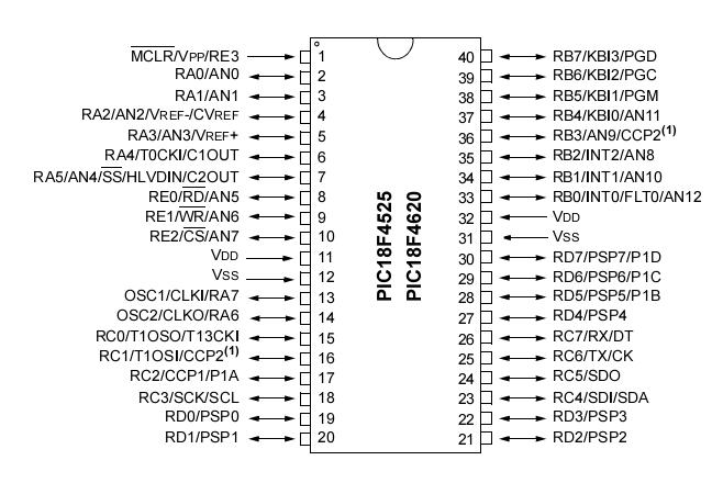

wow, so i got the pikkit and the 18f4620,, along with it came with Microcode studio, I figure that s my platform, i understood most of the demo files,
1) Is there tutorials i can get, what language am i dealing with, is it called microcode?
2) I noticed that each pin had 3 names to it, does that mean I can set up almost all the pins to be data I/O ? how do i set?
3)PORT D is parallel slave port data, can I use this for my PWM inputs & outputs? OR do i need to use pins 16 & 17?
4) could i perhaps get a simple code somewhere to; input one pulse, store it as a variable, then output it,,, and the pins it associates with.?

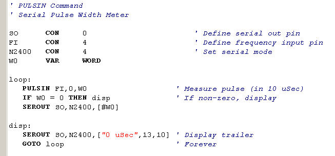

um well, I learned basic when i was a kid on the old atari's, , so that may be the best, still this microcode studio seems ok to me, i am just having problems defining my variables and assigning data to pins,
what is the microcode language that i am using called?, enclosed is an example.....
Also am i getting it right that;; ie.. pin21 can be; my PWM input pin, TTL data I/O pin, or an analoug input?

No chance whatsoever of any kind...
Micro controllers are programmed in three primary languages.
ASM, which is chip specific.
Basic, which is compiler specific and chip specific as well.
C, which is compiler and chip specific as well but allows more ASM like control over the program code. Micro C is basically a hybrid between ASM an C, where basic will take the whole thing out of your hands, but not basic can compete with well written C or ASM code.

I don't think you will find an example of 4 channel ppm (pulse proportional modulation) anywhere and you will have to write your own. If you use a port with interrupt on change (Port B) then you will get an interrupt whenever a signal changes. Use the interrupt to time the width of the pulses and then use the other 4 pins to output the new values. I did an example in C showing how to output a servo value. That thread ended up with various examples. clicky. Somewhere I have code to read a pulse but I think that is in C as well.
