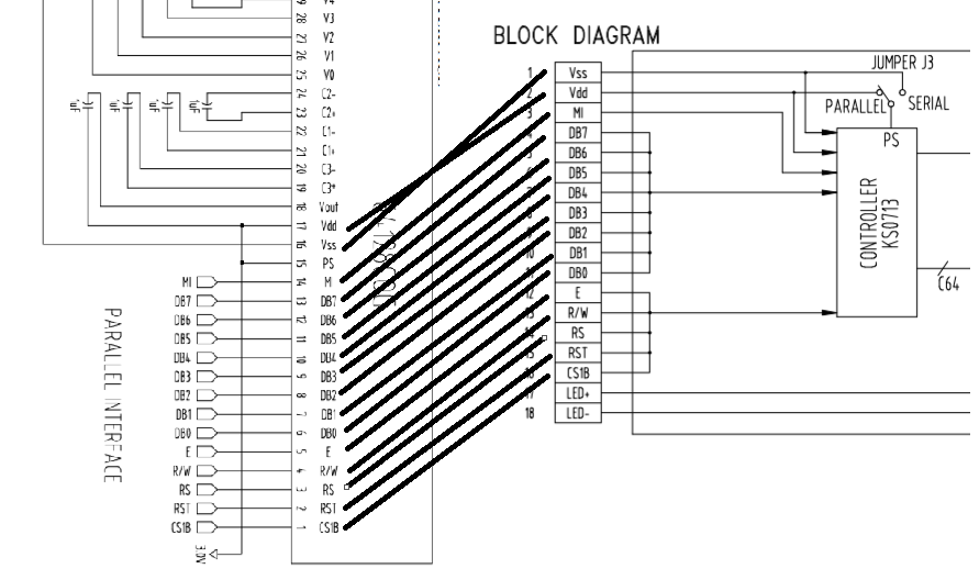

Interesting that Vss and Vdd are not in order. 16/18 pins match and two do not?
I am not saying that the data is wrong. I am saying that you should double check that.
Not like there would be an error in a data sheet.
----------------edited--------------
Left side pins 15 & 17 are connected together so if you swap 17 down to 15 then all the wires are in order.

Thanks, I was purely going off of the title on each pin and didn't even look at the schematic.

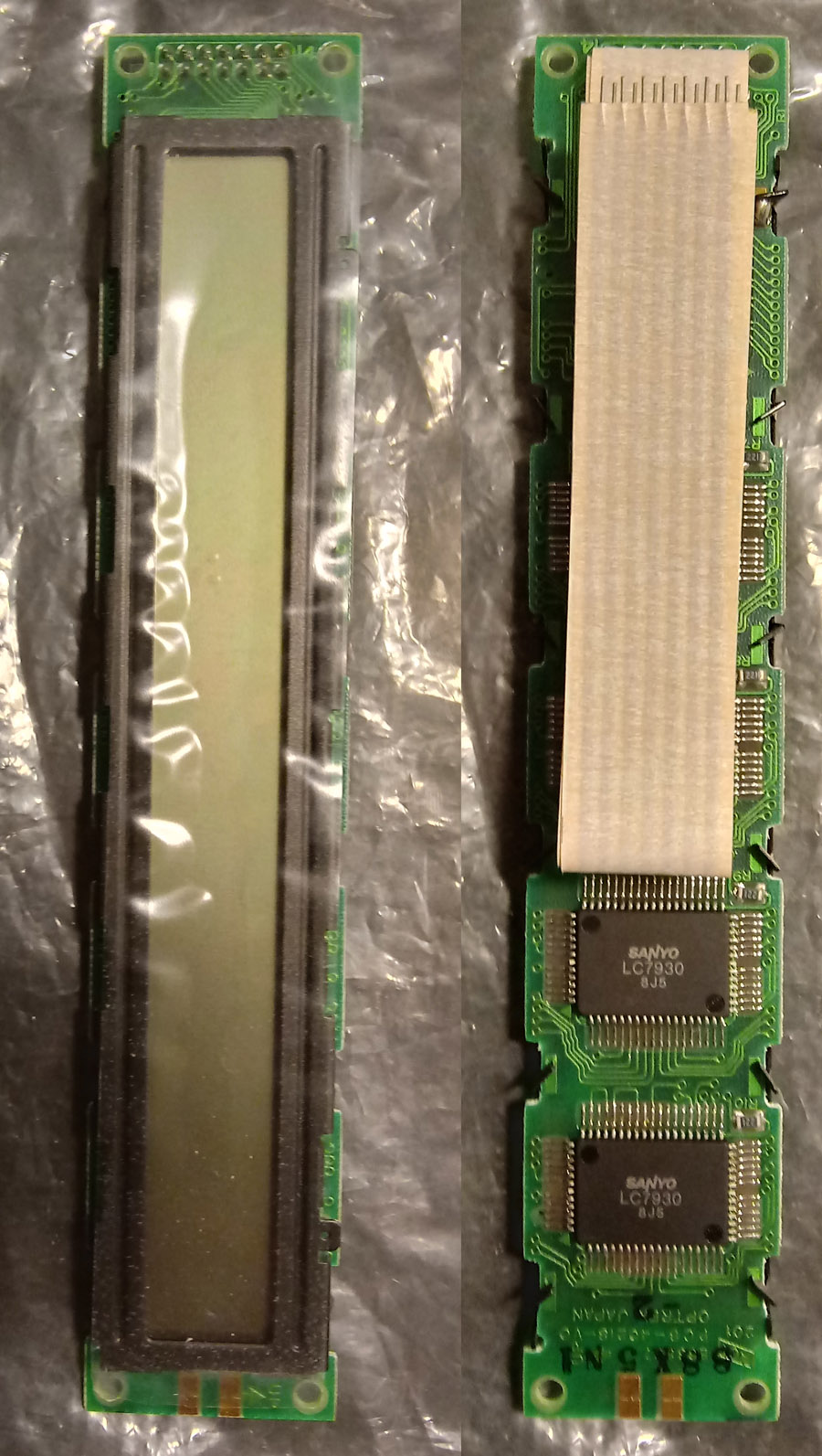

I noticed that also on the one that I looked at the most...where were the anode and cathode connections? I don't know...I have an LCD from the 1980s or so and it has no backlight. I had a fantasy of building my own portable terminal....I take it out and look at it ever so often and think...maybe I should get that working for S&G (if anybody recognizes it and has any data, let me know....bought it off of the back of a BYTE magazine...I did work out the connections at one time I think...if I remember it is also 40 X 2, which at the time was pretty cool....now not so much

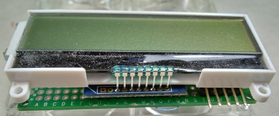

If you have the pin spacing, you can slap them on a board like this one (which has gathered some dust since I did it. Note that although this is a COG LCD, it is using an I2C interface so there are fewer connections. It had 'funky' pin spacing and I had to find a board to match that (the little blue piece) and then, along with a few components, put it on a standard perfboard (the green piece)...it does work well.

EDIT: I have to correct myself, it IS an HD44780A00 controller. Maybe it is not as old as I think it is...also there are 4 Sanyo LC7930 drivers. It is *very* similar to **broken link removed**, except mine has an 88 stamped where that was has a 9x stamp....and socket pins rather than the ribbon. Humph, I probably could try to get this thing working! (I don't know if I should thank you guys or curse you)....and a datasheet!!
