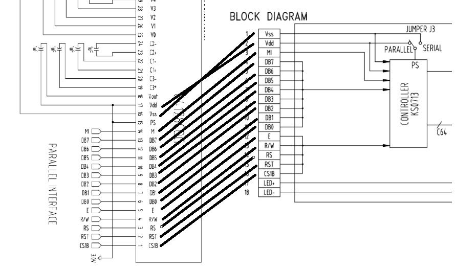

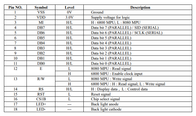

This is the pinout for the 64128E with the KS0713 driver for reference.
119798

I just spoke with someone at focusLCD on their live chat deal and they stated I could use an S61713 or the ST7565 but they would require that the firmware be modified so that it will work. How involved is that?
That is interesting, I don't know what the COG is? so would this essentially not have a driver? Would I connect directly to the terminals on the display and forego the display pcb?
COG=chip on glass. It seems to take the original KS0713 controller. It *may* be functionally identical to the E which is what you have. Here are the datasheets for Displaytech **broken link removed** which you have and the **broken link removed** - you can compare them for compatibility (I have not done that carefully).
The one on the right is the 64128E and the one on the left is the 64128COG. I didn't see the LED but I'm sure I can figure that out. The spec sheet says refer to KS0713 all over the place. I knew that COG was chip on glass but wasn't sure what that meant compared to something with a driver IC. Also, since it didn't state a driver I wasn't sure how it functioned since the others use the driver to decipher the code and relay it to specific pixels.
119810
