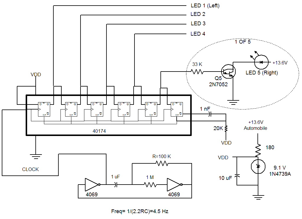

Well, shucks, without getting into the programmable controller argument, I threw this circuit together yesterday and just finished it up. It assumes a 350 mA current for each LED, but can go to 1 amp or so. Give it a try. If it doesn't work, you're out no more than a few bucks. What more can you expect from a free design? :)
could someone design up a circuit using a micro controller and a legend of whats what??
i know its asking alot but it would help me out a lot,
also just because i finish this doesnt mean it'll be the last thing i do like this i'm thinkin of this as getting in the deep end

Using a micro controller is similar to the way colin's circuit is layed out. Except the base of each transistor would be fed into a micro controller I/O line instead of through those diodes and the other analog circuitry on the far left of the image. The main advantage of using an MCU over analog circuit like colins is that with colins circuit you are forever stuck with the pattern the circuit generates. With a micro controller you could change the patterns on whim and customize them any which way you want at any time, including complex non repeating patterns which would require extremely complex analog circuits. Ccurtis and David's suggestions are to use timers fed into digital logic to accomplish the same thing a micro controller would do, again with the inflexibility of once the design is done it can't be changed without re-soldering the board. Considering the cost of modern micro controllers price is not really an issue, and a micro controller will also have a lower part count.
If you want to learn or are more comfortable with analog circuits and their construction go with collins ideas Mind you from the circuit he listed about I think you still need a ramp generator, unless I'm missing something.
If you are comfortable with discrete digital circuits like the blocks you've seen from curtis or david go with their method of using discerete digital chips and timers to generate the results you want.
If you don't want to get too in depth into the analog/digital aspects and don't mind learning a programming language go with my MCU data.
As you can see there is more than one way to skin a cat =)
