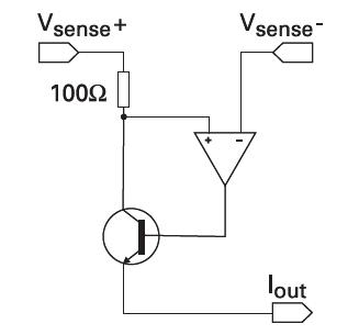

Can I substitue something via the attached schematic I nicked from the ZXCT1009-datasheet?

yeah, but we don't have digikey and mouser. I am in Germany.
Plus the IC lacks some 10V in voltage.
Find a German distributor for Zetex and get a ZXCT1081

The resistor I want to use to do the current sensing is a small value in line with the positve supply rail that I have available (V=+30V). So if I try to hook up a schmitttrigger to sense the voltage after the resistor and feed the opamp from the voltage before the resistor the switching voltage for the schmitttrigger will be V with a small window of V+50mV and V-50mV.
Will it work to build a schmitttrigger from an opamp with a switching voltage being exactly the positive supply voltage of the opamp?

No it won't work. But that's not a problem because I don't beleive you're gonna feed the opamp with ±50mV. You shold feed the opamp with at least ±3V (minimum voltage differs between different types opamps).
attached a sketch:
I guess this won't work b/c, if I use the rail voltage of 30V to feed the OpAmp, the switching voltage will be at or above the supply voltage.
So how would I adapt to make it work?

Hi. No I doesn't think that gonna work. As I have understand the problem, you doesn't have only a lower and an upper hysteresis level, but you also have a zeero point between (or close to zeero) that shall turn off the output. That requires two schmitt triggers, and a simple logic gate after.
I don't know how you understood the problem, but I can rephrase it for you with the aid of the schematic I scribbled earlier:
If the voltage drop over Rsense is positive, U(PSU)>U(LOAD), then I want the output at 0V.
If the voltage over Rsense is negative, U(PSU)<U(LOAD), then I want the output at +5V.
Ok, then I assume you can get along with a regulat comparator.
