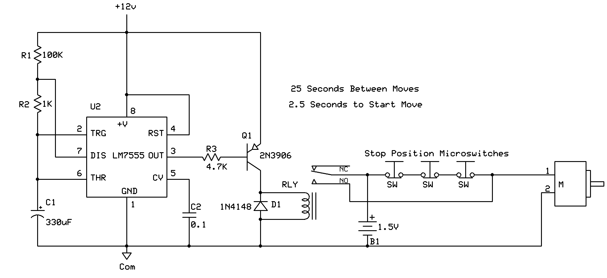

I have a DC motor that runs off a 1.5v D-sized battery. It is a motor that is inserted into a tube and has a connection peice that allows for 3 posters to be attached and they spin when the motor is turned on. The motor turns too quickly to allow for the info to be read. How can I slow it down or (even better) fix it up to spin a 1/3rd of a turn, stop for a about 30 seconds than turn another 1/3rd and stop for a about 30 seconds, etc?

The standard solution is to gear it down so the output of the gearbox rotates once for every 3 turns of the motor. Increases torque, lowers speed, and decreases motor current and heat.
Or you could feed it 1/3 the voltage or PWM it at the current voltage but with a 30% duty cycle. BOth of these methods however, decrease speed and decrease torque (possibly to the point where it is too weak).

Try putting a diode rated for constant current at 1.5 or 2X the motor's peak draw inline with the battery. That's a quick and dirty way to blow off a little power. Add more diodes, you'll get a slower motor, keep in mind this power is lost as heat in the diode itself depending on the current, so plan accordingly.
You could use a couple 555 timers to have the motor run for a given time and then stop for a given time. The first 555 would be connected as an astable multivibrator with a period of 20-30 (plus the period of the second 555) seconds. This would trigger the second 555 connected as a monostable multivibrator (one-shot) with a period sufficient to run the motor for 1/3 turn. The monostable will need a transistor amp to power the motor.
You can Google "555 timer circuits" for many references on how to design the circuits.
Just throwing together a concept. A 555 astable and three limit switches to stop the motor at the three positions and restart it after a delay. Sort of reminiscent of the windshield wiper delay circuits. ;)

Try the diode first =) Can't beat a penny part you just stick in vs trying a couple timer circuits you may or may not be familiar with.
As Sceadwian says, try the diode first. Pop into the electronics store on the corner of Church St & Washington Lane and ask for 1N914, 1N4148 or something from the 1N400X series, they should have them. You could also have a chat with the tech (older guy about 5' 6") he was always helpful when I spoke to him in the past.
HTH.
If the motor is running off of a D-cell, a 1N914 or 1N4148 might be a little too light on the absolute maximum If. Espacially for the motor start-current. The 1N400x would be a whole lot safer.
