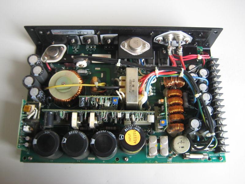

The power supply is a Sorensen or maybe a KYOSAN Model SCB306A-02, I can find no information on the web about it. I just figured it could handle whatever I through at it.
Any one possibly know if there is a way to adjust this down to 12v where is is suppose to be.

Try running your supply with a ~ 5A load on the +5V line (a fair-sized load may be needed for proper regulation) and a ~ 10A load on the '15.4' V line and let us know the measured voltages across both loads. That may give us a clue as to the feasibility of this project.

A 1 Ohm resistor will draw 5A (so it's a 5A load) from a 5V source and dissipate 25W. That is probably a greater load than you need to check the regulation. Do you have any low (< 10 Ohm) value high wattage resistors to hand?

Readings I get on the 12v line:
15.3v no load
15.6 with 10 ohm on 5v line
14.6 with 2x10 ohm in series on the 12v line
The resistors only got slightly warm if that matters

i understand it as an SMPS managed with a initial step-down transformer for isolation.
it has multiple outputs.
while loading 5V supply (being in control loop ) and managing 15V is correct,
perhaps it could be done this way.
try to manage to change the control loop from 5 V to 15V line, change the resistor divider to get 12V output. Generally they use TL431 as controlling element. Then on, on it works with 12V perfectly regulated. Other voltages would reduce to the proportion.
BTW, can you check what switch mode IC they used as per the unit by physical check and identify the feed back section?
Any schematic or block diagram, in the user manual that you may have?
Interesting that the 12V line actually rises slightly when the 5V line is loaded. Both that, and the fact that the 12V line drops when loaded, suggest the regulation is done on the 5V line only.
So with only a ~11W load (20 ohms, 0.73A) on the 12V line it drops from 15.6V to 14.6V. I would expect it to drop a lot more if you increase the load significantly. That confirms a simple resistor won't be the best solution to getting a target voltage of 12V, and an active component (e.g. FET) will be needed. However, I'd be very surprised if the 12V line can provide enough current for driving the Pico. At a peak power of 200W you need ~ 16.7A from that 12V line !!!
