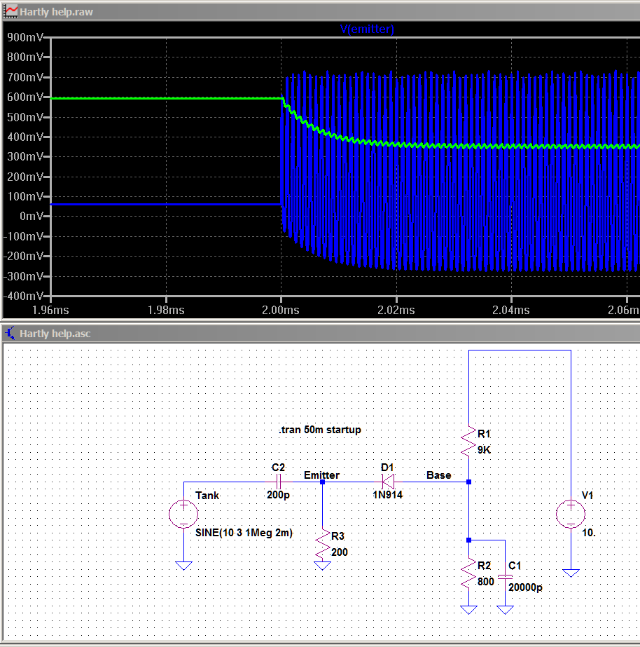

I've made a simulation of this circuit;
Collector = Red
Base = Green
Emitter = Blue
it is clear that there is a dc bias builing up after oscillations start, but how??
If the feedback is too great, the BE junction can become reverse biased on the peaks of the tank voltage. The circuit will still oscillate, but the output will be distorted. Ideally, the BE voltage does not reverse but drops to a value (as the voltage across R3 rises) just below the cutoff bias of the transistor.
Something I don't like about the explanation you quoted, though, is the average DC voltage developed has more to do with the rectifying action of the BE junction than the time constant of C2 and R3. The magnitude of the average DC voltage at R3 developed from the feedback depends on the values of C2 and R3, but the fact that it is DC has to do with the BE junction diode.
Does that help?
This equivalent circuit may help to explain it further. The diode is the BE junction of the transistor. The source (labeled TANK) is the output of the LC tank. There is the C2 and R3 shown, and the bias resistors, R1 and R2, and the bypass capacitor, C1.
The same, reduced, DC voltage is developed at the base with some ripple on it due to the time constant of R3 and C2. The ripple is also very dependent on the value of C1.
Green -- base
Blue -- emitter
