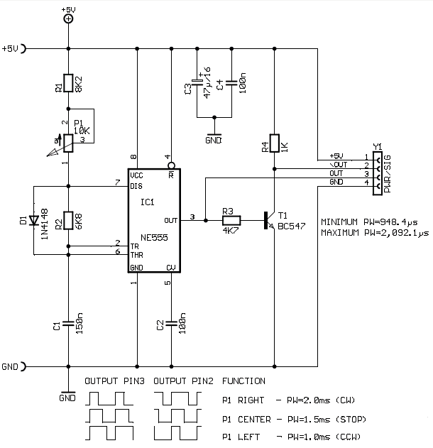

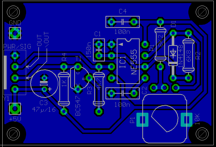

I guess you are talking about an RC speed controller. It requires pulses varying in length from 1 to 2ms, while 1.5ms is the neutral position (motor off).
Here is a cheap circuit which can be used for servo testing as well.
It features a dual output, one logical high and the other one inverted.
Board design is purely single sided and dimensions are 47.95X32.7mm (1.8875X1.2875").
If it fits your needs please PM me your full name and email address. I'll send the Eagle files right away.
Regards
Boncuk
