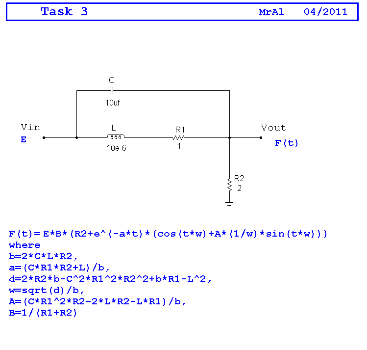

In the mean time, here is a solution for Task 3, although i dont know what good this will do for you :)
The circuit is shown in the attachment. There's one inductor and one capacitor and two resistors. They didnt give us the input again, so we assume a step input.
We are already given the frequency domain equation:
F(w)=(w*C*R1*R2+i*(w^2*C*L-1)*R2)/(i*(w^2*C*L*R2-R2-R1)+w*C*R1*R2+w*L)
and we note that there are powers of w in this equation and if we multiply top and bottom by i we will get pairs of (i*w) and its powers again:
F(w)=(i*w*C*R1*R2+i^2*w^2*C*L*R2-i^2*R2)/(i*w*C*R1*R2+i^2*w^2*C*L*R2-i^2*R2-i^2*R1+i*w*L)
and now we simplify this and we get:
F(w)=(i*w*C*R1*R2+i^2*w^2*C*L*R2+R2)/(i*w*C*R1*R2+i^2*w^2*C*L*R2+R2+R1+i*w*L)
and now replace every i*w with s again we get:
F(s)=(s^2*C*L*R2+s*C*R1*R2+R2)/(s^2*C*L*R2+s*C*R1*R2+s*L+R2+R1)
and now transforming that to the time domain we get the solution shown below for F(t). This is a second order transfer function and this is usually what comes up when we have two energy storage components in the circuit ie one order per energy storage element. Sometimes we get lucky though and get a lower order equation when some elements combine in a certain way.
This equation is a bit harder to transform so you should look at ways to transform these equations on the web. The time domain equation here comes from using Inverse Laplace Transform methods. There are lots of sites showing these methods.
So the general solution comes out to be:
F(t)=E*B*(R2+e^(-a*t)*(cos(t*w)+A*(1/w)*sin(t*w)))
where
E is the input step amplitude,
b=2*C*L*R2,
a=(C*R1*R2+L)/b,
d=2*R2*b-C^2*R1^2*R2^2+b*R1-L^2,
w=sqrt(d)/b,
A=(C*R1^2*R2-2*L*R2-L*R1)/b, and
B=1/(R1+R2)
There are three distinct cases for this general solution so a couple notes about this solution are surely worth mentioning.
First, you'll note that the variable 'd' is found inside the square root, so we have to take the square root as part of the calculation for the angular frequency 'w'. 'd' is often called the "discriminant", and tells us some interesting facts about the solution. 'd' takes on three different classes of values, either negative, positive, or zero. You can note that the class of 'd' depends on the component values so depending on those values we'll get different values for 'd'. If we get a positive value for 'd', we note that sqrt(d) is real and that makes 'w' real also, so we can use the general solution directly. If we get a negative value for 'd' however we note that sqrt(d) is not real and so that makes 'w' imaginary, and if we get zero for 'd' sqrt(d) is zero and that makes 'w' zero also.
Now if 'w' comes out imaginary, that makes the sin and cos functions turn into sinh and cosh respectively, and the sinh term ends up being imaginary. However, since 'w' is also imaginary that makes the whole sinh term come out real. That's why i left the factor (1/w) out in front of the sin() term so that in the case where 'w' is imaginary we can reduce that whole term to a real before we proceed with the calculation. Now if 'w' comes out to zero we have another little problem. With that factor (1/w) again since the w is in the denominator that would make this factor (and thus the whole term) indeterminate, and so instead of calculating it directly we have to take the limit as 'w' approaches zero. That reduces that whole term to simply A*t. Also, with w=0, cos(w*t)=1 and that simplifies that term also.
So we have three separate cases:
1. d=positive and so w=real,
2. d=negative and so w=imaginary, and
3. d=0 and so w=0.
For case 1 we apply the equation directly, for case 2 we have to replace sin and cos with sinh and cosh and we have to reduce i*sinh() term to a real, and for case 3 we have to take the limit of the sin() term and cos() goes to 1.
Mathematically this happens automatically so we dont really have to do anything, but when we go to calculate it with a calculator or even a computer those programs usually can not handle the symbolic math required for the reductions so it's a good idea to know how this formula changes. Ultimately what i like to do is solve the general equation for the three separate cases and code them individually in a program and solve for the three different conditions of d and w.
This would look something like this:
if d>0 then
Do Case1
elsif d<0 then
Do Case 2
else
Do Case 3
Also, when d is real the response is called under damped, and when d is imaginary the response is over damped, and when d is zero the response is critically damped. I like to think of the under damped case as "wild and oscillatory", and the over damped case as "lazy and slow", and the critically damped case as "just barely over damped".
The "damping factor" can be found from examining the denominator of F(w), and that tells us something about the solution right away even before we transform it to F(t). Im sure there is much about this on the web too.

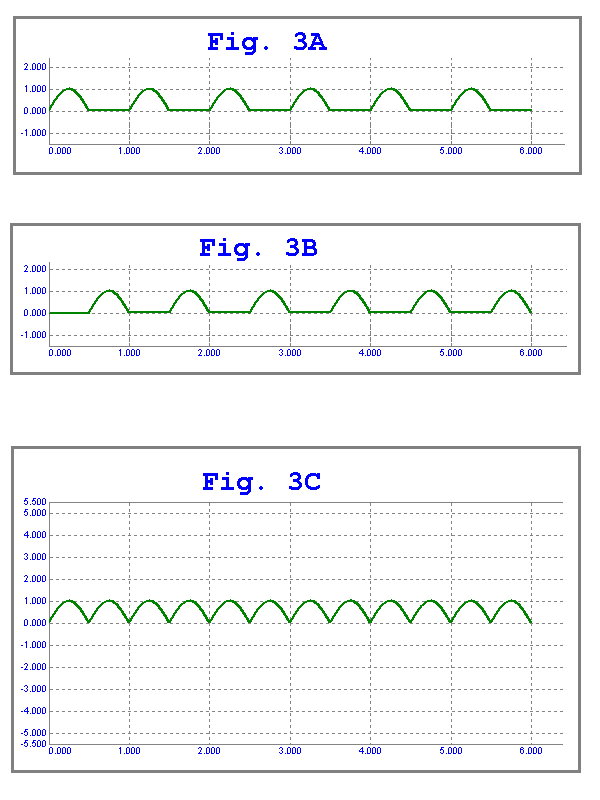

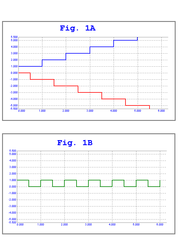

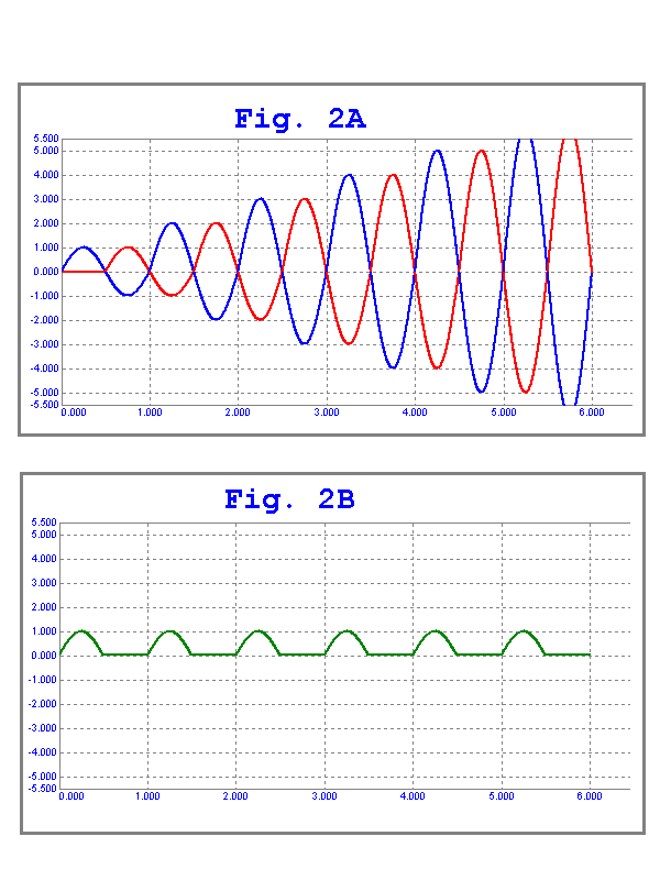

Next, Task 9 wasnt too hard so i did that one next.
They are asking for the mathematical model of the full wave rectifier with sine input first, and also the model with a capacitive filter with some series resistance and some load resistance.
In the following, a 'stepped' sine wave is a stepped wave similar to a staircase except for each step we have a sine wave of one period that increases by 1 for each step. Using a stepped sine wave allows us to use the time shift and time periodicity theorems to develop a full wave rectified sine. This stepped wave is not to be confused with a sine wave that is approximated using small steps for tiny fractions of the wave, but instead each step is a complete perfect sine where its amplitude increases by 1 for each additional step. This is a rather unusual looking wave that has abrupt transitions between each period, but it enables us to use some common theorems that are the same for all waves. The wave itself looks first like a sine of amplitude 1, then the next period it is a sine of amplitude 2, then for the next period an amplitude of 3, etc., etc., and if left by itself it would increase forever, but we add to it another wave which cancels part of it out so we end up with a half wave rectified sine and that's when it gets easy. I'll post some waveforms as soon as possible as this is really quite neat to see graphically.
We start with a sine wave who's transform is:
w/(w^2+s^2)
and we'll use a frequency of 1 Hz for now so we get:
2*pi/((2*pi)^2+s^2)
Next we'll define a few things to make the notation simpler:
W=(2*pi)/((2*pi)^2+s^2) [note period is 1]
E1=e^(-s/1) [note period is 1]
E2=e^(-s/2) [note period is 1/2]
Using the time periodicity theorem 1/(1-e^(-s*Period)) we get a 'stepped'
sine wave starting at zero and amplitude increasing by 1 every period:
W/(1-E1)
Using a time shift of 1/2 period we get a stepped sine wave that is the same as above
but is delayed by 1/2 period:
W*(E2)/(1-E1)
Adding that to the original stepped sine that was not delayed we get:
W*(1+E2)/(1-E1)
and because the inverted stepped sine wave cancels every other cycle of
the original sine, that gives us a half wave rectified wave above. Thus,
a half wave rectified sine looks like this:
W*(1+E2)/(1-E1)
Now if we delay that by 1/2 period we get:
W*(1+E2)*e^(-s/2)/(1-E1)
or in simpler notation:
W*(1+E2)*E2/(1-E1)
and that gives us another half wave rectified sine, except that is now delayed
by 1/2 period from the first half wave rectified sine. This would look just
like the original half wave sine but would be delayed by 1/2 period.
Now that we have expressions for a half wave rectified sine and another half wave
delayed by 1/2 period, all we have to do is add them together and we get a
full wave rectified sine:
F(s)=W*(1+E2)/(1-E1)+W*(1+E2)*E2/(1-E1)
This works because every time the original half wave was active the other
half wave was zero, and vice versa.
The above simplifies to:
F(s)=((E2+1)^2*W)/(1-E1)
and all we have to do now is replace the W, E1 and E2 with the original
definitions and we have the required transform for the full wave rectified sine,
and then we can use an identity to simplify further.
The resulting exponential terms can be simplified into a trig form with:
coth(a*s/2)
using the identity:
coth(b)=(e^(2*b)+1)/(e^(2*b)-1)
So we end up being able to simplfy this transform into:

I thought it would be better to start with a regular stepped
wave (staircase) and show the transforms for them and how they
add in time.
Repeating a few definitions to make the notation simpler:
Refer to the three attachments to view the figures.
Starting with a rising staircase with step period 1
(Figure 1A, blue waveform):
1/((1-E1)*s)
Using time shift and inverting that wave we get the same
wave but it is delaying by a period of 1/2 and is going
down instead of up (Figure 1A, red waveform):
(-E2)/((1-E1)*s)
That gives us two waves shown in Figure 1A, one that is
going up and the other that is going down but delayed by
1/2 period. When we add the two waves we get a pulsed
wave that does not increase but stays level. That is
simply the algebraic sum and is shown in Figure 1B.
Thus, we can see that two waves that are increasing can
sometimes add up to a wave that looks normal and does
not increase but simply repeats.
Now on to the actual transform of the full wave rectified
sine wave.
w/(w^2+s^2)
and with period 1 is:
and that is not graphed as it is just a sine wave.
Using time periodicity we get a strange 'stepped'
sine wave (Figure 2A, the blue wave):
W/(1-E1)
Note that this wave does not increase smoothly, but it
makes abrupt steps (just as with the simple staircase wave before)
as each sine period is complete in itself and
for each period the sine amplitude increases by 1.
Next, we use time shift on that same wave above and this
results in the same wave but it is delayed by 1/2 period
(Figure 2A, the red wave):
W*(E2)/(1-E1)
Now when we take the above two waves and add them together
they partly cancel each other. For every positive half
cycle of the blue wave the red wave only partially cancels
the blue wave, and for every negative half cycle of the blue
wave the red wave completely cancels the blue wave. When
the red wave only partially cancels the blue wave what
remains is a half cycle of the original sine wave, and when
the red wave completely cancels the blue wave what remains
is zero. This new wave is shown in Figure 2B and it is
plain to see this is a half wave rectified sine wave.
The entire transform is simply the sum of the above two
waves, so we get:
W*(1+E2)/(1-E1)
That is the transform of a half wave rectified sine, where
the positive half cycles of the original sine appear in the
wave but the negative half cycles are canceled out.
It is shown in Figures 2B and 3A.
What we want is a full wave rectified sine, and noting the
only thing missing from the above wave (Figure 3A) is the
other half of the waveform and noting that if we were to delay
that wave by 1/2 period we would get the missing half, we do
just that. We delay the above wave by 1/2 period and that
gives us the other half (Figure 3B) and the transform is:
W*(1+E2)*E2/(1-E1)
Now that we have both halves, we simply add them together
to get the transform of the entire full wave rectified sine:
and that final wave is shown in Figure 3C.
The final transform can be simplified in various ways and
i leave that to the reader.
