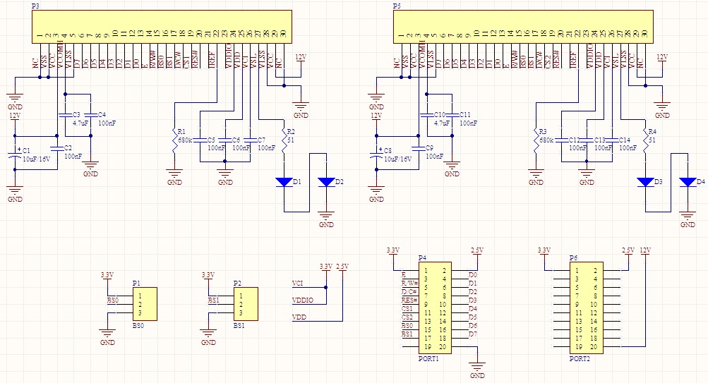

Hello!
I have some problem with display UG-5664 w/controller SSD1322.
It doesn't want to work. :(
There is initialization code below:

Connection scheme include.
Please, help. What i do incorrect?
