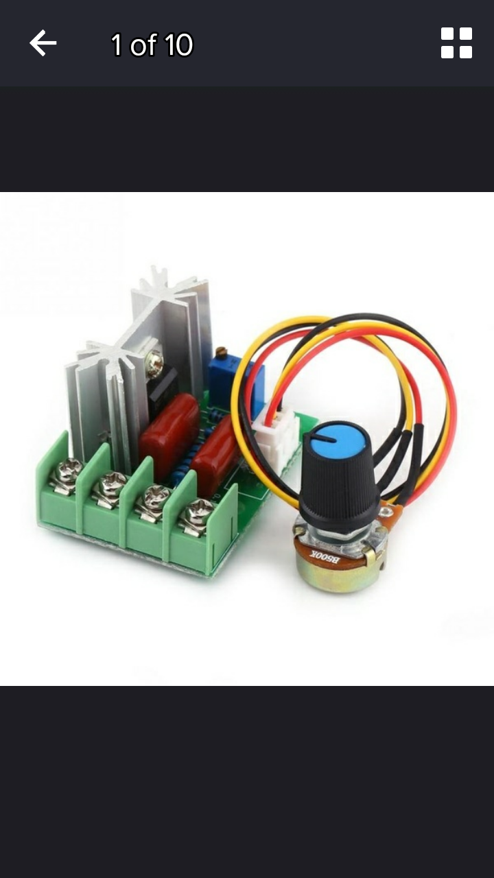

I purchased a speed controller off of Wish(I know) now, it says this thing is 220v AC input only. It's spec's apparently are Input: 220v AC Output: 50v-220v 2000w (input must be 220v) Now my problem is where in the world do I find a 220v input that runs on just 2 wires +&-. Pictures below. Thanks
It looks like a simple TRIAC controller and should work fine with 120VAC.
Nothing bad will happen if you connect 120vAC to try it.
Just bear in mind that any part of that circuit could be at mains voltage :eek:.
The + & -, if it has those markings, will presumably be the output to the motor.
The other two terminals should be AC input?
Yea it's marked input output, one second I'ma link it's "description" given by the company, better yet gonna copy and paste.....

They even emailed me making it seem like I was completely daft stating, it's not possible for it to be 110v AC input......I think the Chinese are trying to get me electrocuted.
Also thank you all for the helpful replies, it being my first post and me not being really well versed in electrical things( I have a friend I go to and clear just anything I'm thinking of doing to make sure I don't get killed) and I generally don't mess with anything over 12v.....but due to me not paying attention I ordered two of these things.... when I needed something else all together.... anyway, I guess the safest thing to do is to wire it up, plug it up and test it with a voltmeter? I just can't see how this thing is supposed to be 220v AC input.....
Wire it up to a 110V supply and connect it to a lamp, to see what it does.
I'd guess that, at worst, it may not be able to give full output on 110V without a resistor change - or the preset pot on the board adjusting?
Do NOT touch it while it is plugged in to power, the whole circuit board is live and could be lethal....

Lol I'm in Texas, and as stated before I'm new to all this, let me be more clear on the two wire deal, I know that 220v plugs have 3 wires , one of those being ground, the board has only two slots for input, one of which is negative. So when I say how do I find a 220v input with two wires i mean one with 1 hot and one negative. And yes my plan is to hook it up to some LED strips I have lying around that need 55 v to light up with it control at its lowest setting. And with the board screwed onto a piece of wood but ty for the reminder.
Please try to connect to 120VAC before you try 220 (240). The controller you have is based on a triac. The triac will work no matter if it is 220, 120 or 24VAC.
The two-wire 220 is just the two live wires (no neutral).

OK, Texas ... Yes, they have 240VAC with two wires = "Hot-to-Hot".
It appears that you have no place to connect a Neutral or a Ground wire to your Speed Controller
Can you post a better photo of the AC input connector ?
I do not understand your Input connections, "... the board has only two slots for input, one of which is negative ..." ???
What does it say on the Four (4) Screw Terminal Strip?
[ AC Input ] ... [ - ] ... [ - ] ... [ Load ]

I understand that 220 uses two live wires, what you haven't seen is the bottom of the board, where it's marked Neg on both sides, these terminals are linked together and to nothing else which leaves me to believe they are both truly Neg. No I haven't tested it yet on any voltage as my "handler" lol has been quite busy, and I promised him I wouldn't go trying to hook this thing up alone. Thanks again ever.

I understand that 220 uses two live wires, what you haven't seen is the bottom of the board, where it's marked Neg on both sides, these terminals are linked together and to nothing else which leaves me to believe they are both truly Neg..
What do you mean by 'Truly Neg'?
The only difference between a 'Live' conductor and N is that the N is referenced to earth ground, the board should not be able to tell the difference, ONLY if the N were connected to ground source, but this would be totally illegal.

i think the OP has his plate full already, bringing in 3-phase into the discussion will only tend to confuse things further. this discussion has been about single-phase and "split phase" house wiring, and whether he can use his TRIAC controller on a normal single phase outlet.
to OP: the only thing that might cause problems with your TRIAC device is if the breakover voltage of the trigger diode (a DIAC that triggers the TRIACs gate) is higher than 120V.
