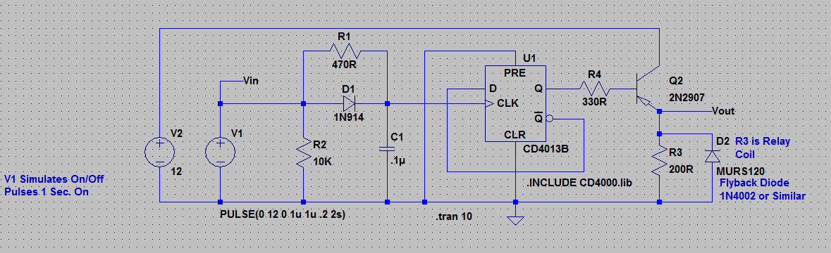

i found this circuit:
one-button-toggle-relay-gif.51420
only i dont have 2n2222 i have only 2n3904
Can 2n3904 work in this case or if not which would be a good replacement?
Maybe. It would depend on your relay spec. What is the relay coil voltage and current rating?

The 2n2222 and 2n3904 are often used interchangeable for general purpose transistors. The BIG difference is the 2n2222 has an absolule max collector current of 1A and the 2n3904 is 200 mA, The coil current is the determining factor.
The coil resistance is probably 90 ohms or about 151 mA at 13.6V , The 2n2222 is probably a better choice, but the 2n3904 will likely work.

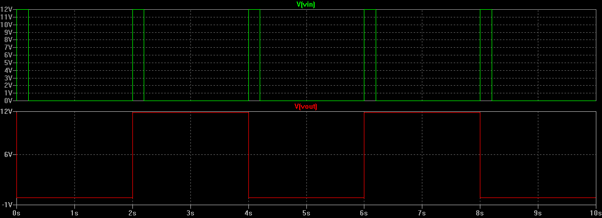

I would use a circuit along these lines:
V1 is simulating the button push. R1, R2, D1 and C1 take care of switch bounce which I mentioned earlier. R3 simulates the relay coil and D2 acts as a flyback diode to surpress the spikes when the relay coil is deenergized and the field collapses, a 1N4002 will work. Q2 is a common 2N2907 transistor which turns the relay On and Off. V2 is 12 volt power which can be 12 to 14.5 automotive power. I would use a decoupling .1 uF capacitor on the power pin of U1 (power pin not shown). This circuit is rough but should do what you want. Remove V1 and put a normally open push button between Vin and 12 volts. I used a PNP transistor to make switching the high side easier as you mentioned high side switching.
The outputs look like this:
There are other ways to go about it but I would just use a common D flip flop circuit built around a CD4013 or equivalent. The parts can likely be had at Radio Shack or smilar retailer.
