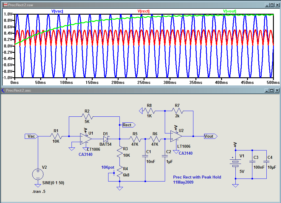

This the simplest precision rect I have seen, it works well.
Point to note it gives a precision fullwave rectified signal, so for a steady 'dc' level you require a peak detector and filter.
Unless your program is going to sample the fullwave signal [ testing for max voltage]

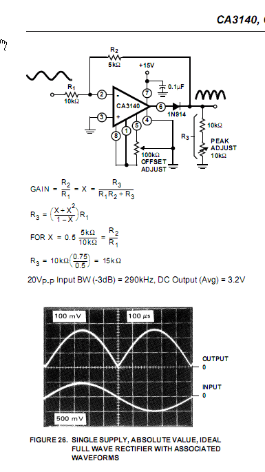

Look at this image.

i just need to adjust the gain on ericgibbs circuit... how would i do this?
What level of gain do you require.?
Making R7 [2K] a variable resistor will enable you to set the gain of the second stage.
Also what reponse time time do you require.?
i need a adjustable gain so i can change the voltage of the ac into a 0 to 5v range for inputing into my sample and hold (LF398) and acquision time doesnt matter because i need to take reading every 0.5 seconds... which i think i can get from LF 398, the gain is not decided yet as im going to experiment with different CT and load resistors, but something from 1 to 80 ish would be good
Does anyone have a good diagram for a LF398, i need to know the voltage that the sample and hold logic needs to.... sample and hold, im going to run the logic from a 555 so i can get 2 hz is this a viable option or is there a onboard clock ?
thankyou for your help
in your circuit R7 is to adjust the gain, is that in relationship with R8, so is that R7/R8+1 equalling a gain of 3...
also wot does R4 do?

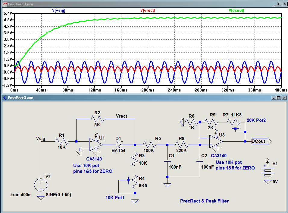

Look at this image.
The prec rect reduces the peak level to half Vac in.
It would help if you told me the level of the input Vac and the required 'dc' level output.
Ref the PM's I cannot post images on PM,s.?:)
EDIT: the image shows a Vac in of 1Vpk [ 2Vppk] and Vdc out of +5Vdc, smoothed.
