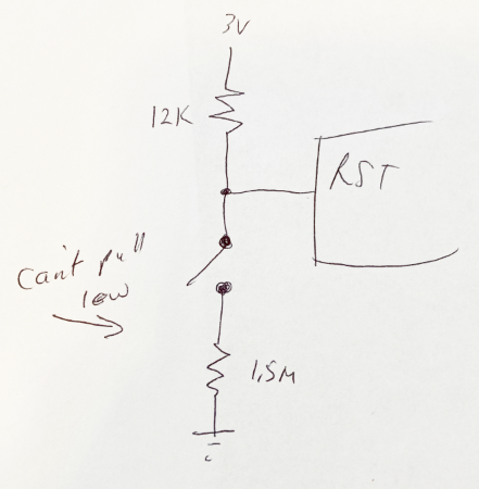

I'm trying to make a battery operated water sensor. When there is water between the 2
leads the resistance is around 600K - 1.5M.
Although I'm an electrical engineer I cant say I understand transistors...
Is there a way with a transistor circuit to pull that reset line low WHEN
the resistance on the water leads goes from OPEN to 600K-1.5M ?
Or any other suggestions on a method to accomplish this, preferable where
it doesn't use power when no water is present : )
Thanks much for any help
tim

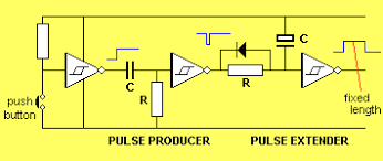

Look at the first two stages of this example:
The push button would be the electrodes. When the first input changes to low, the capacitor passes a high to the second input for some time, depending on the capacitor and resistor values. 0.1uF and 100K could be a good starting point.
The output of that second inverter gives you the low-going pulse for the reset input.
Adding a small capacitor across the electrodes would give a power-on reset effect and reduce noise sensitivity.
