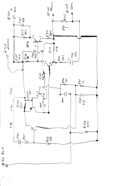

Pls see the atached circuit diagram.

I saw the diagram you drown, i am a beginner in electronics so i understand very little from this. but thank you for your efforts.

The circuit diagram references the various connection lugs. #705 and #706 is the connect points for the IR LED. The reason I say this is because in your photos in post 1, the black and orange wires seem to go to these points. can you check this?
#704 is the + supply connection, and I reckon #703 is the - supply connection; but I have no idea what #701 is used for. The suggestion is that #701 'should be' the connection to the IR LED anode.
My confusion is that I 'think' I got the connection of the IR LED correct, but did I?
Looking at the value of R715, I thought the resistance value was 270 ohm. The colours I got were red - purple - brown. Can you check this. I've lost the photos I had and they are now gone from this thread.

3. there is no R715 the highest number is R714

If there is no R715, then what is the component at the side of the PCB which is hidden in the photo by the wires? Does it have colour bands?

I think now, after reading the data sheet, that the ICOP circuit board you have is a pulse generator for driving such an LED.
By using a pulsed driver arrangement, you will be able to get much higher values of IR light compared to operating the LED in the DC mode. So I believe you should attempt to get the icop circuit going. You can test this circuit board by using a couple of green leds in series as a load rather than the IR LED.
Can you get the transistor type numbers of the transistors on your icop board.

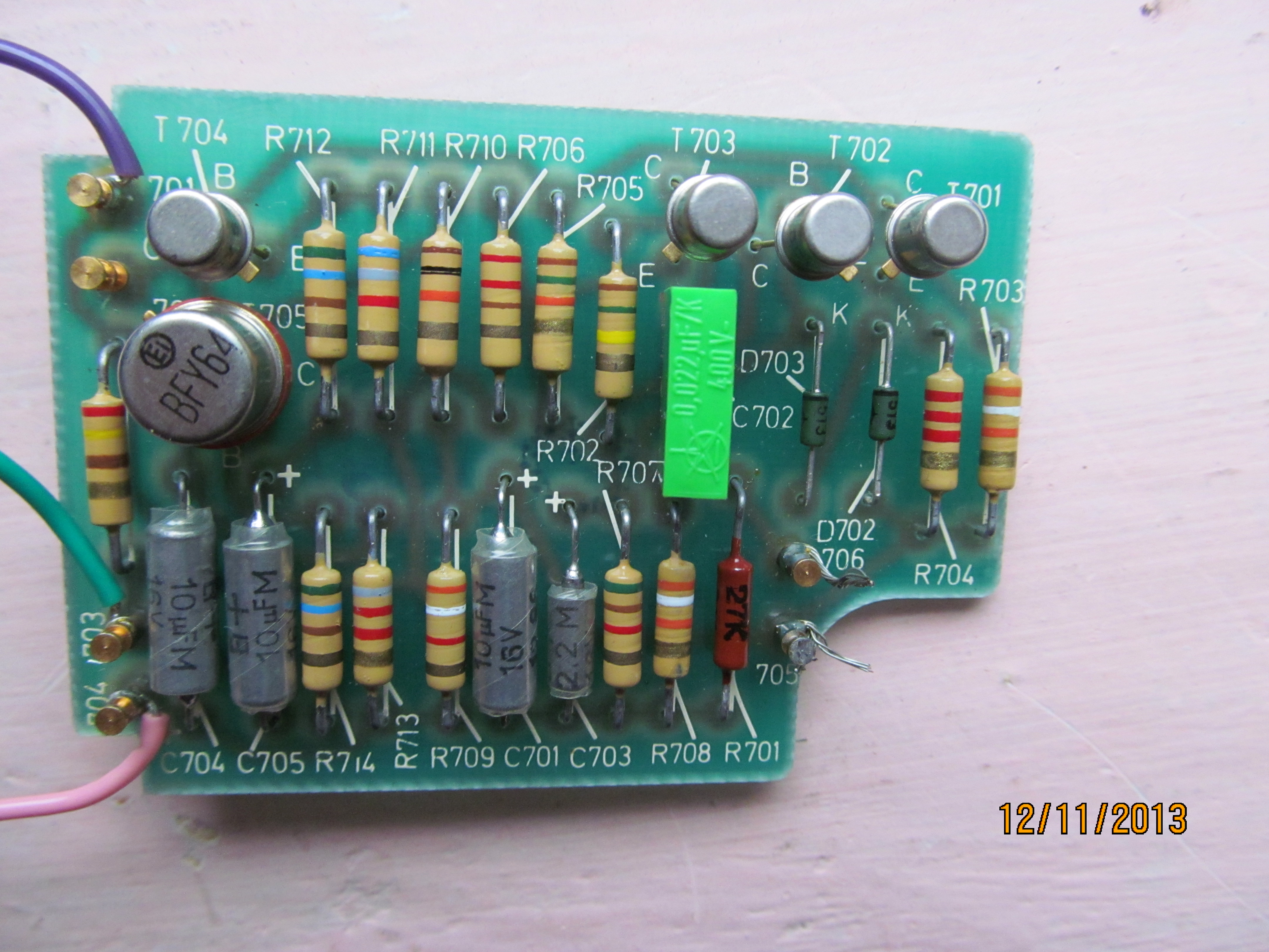

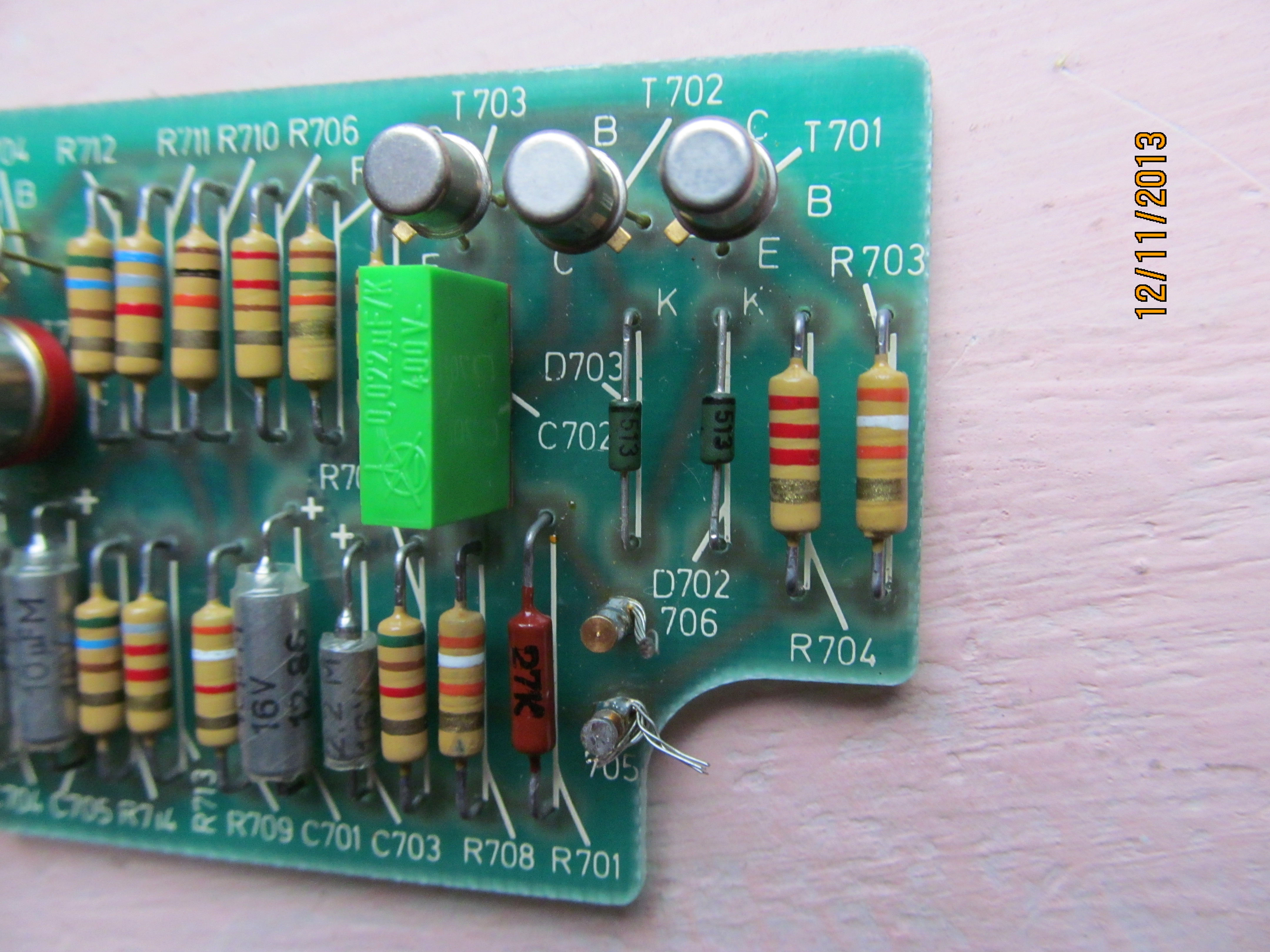

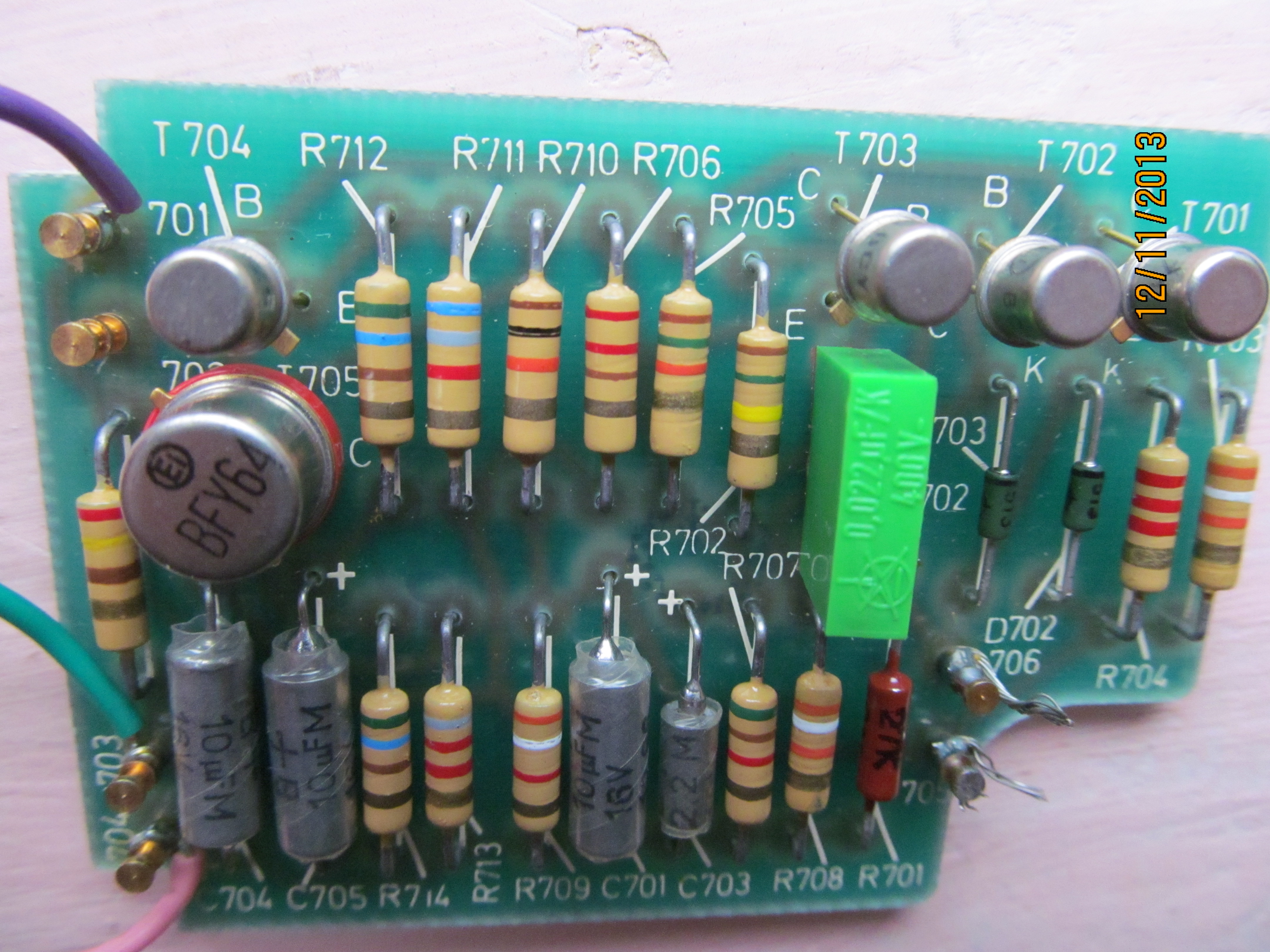

here are some better pictures of ICOP board:
T704 - Ei BCY 57
T703 - Ei BCY 57
T702 - Ei BCY 71
T701 - Ei BCY 71

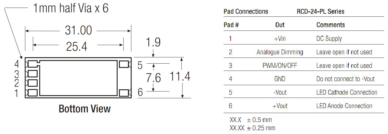

Or can this one work: https://www.digikey.com/product-detail/en/RCD-24-1.00/PL/A/945-1639-5-ND/2766432
here is the datasheets: https://www.recom-power.com/pdf/Lightline/RCD-24PL.pdf
this version: RCD-24-1.00/PL/A has:
Current - Output (Max) - 1A
Voltage - Output 2 ~ 32 V
below the board it has 6 connections, 2 for the led ( pin 5 and pin 6 ) and it has for input voltage ( pin 1 and pin 4 ) ( 6 volts minimum )
the only thing i don't get is how to regulate the output voltage, it says Voltage - Output 2 ~ 32 V but i need 3 volts for my ir led.
so can this power supply ( driver ) work for my led ( OSRAM - SFH4235 ) ?
