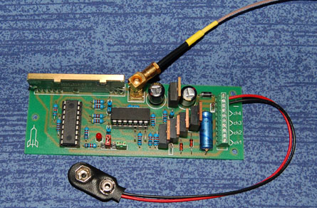

Here's a piccy if one I made earlier!
This gizmo works on 914mhz, and has been used upto about 300metres with a 10mw transmitter into a 1/4 wave dipole antenna.

Thats a sweet lookin PCB. I wish I could make um look that nice.
