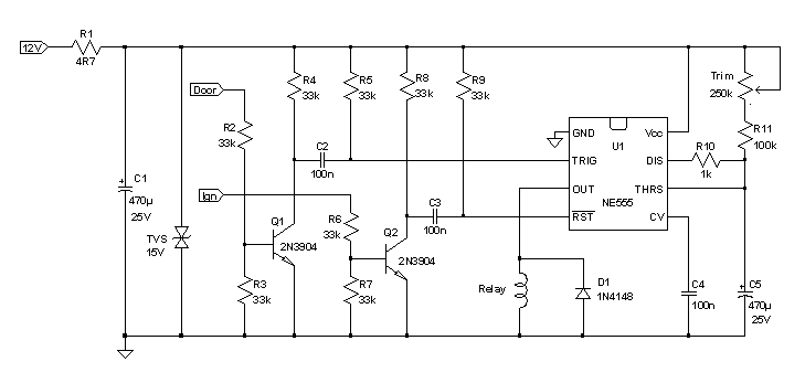

I'm planning on adding power door locks, and I'm hoping I can take the 12v pulse (that unlocks the doors) from them, and use that to activate a 2 minute timer which would power a relay and turn on some interior LEDs.
That much seems simple enough, but I'd also like to tie into the ignition, so that when I turn on the ignition and start the engine, it sends 12v into the circuit and shuts the light off again (before the 2 minutes are up).
And the final complication, is I don't want the lights to come back on when I shut the engine and the ignition off. (finally completing the 2nd 12v "pulse")
Has anybody done something like this? Would it be simple enough for an electronic incompetent to solder together?
I might even make a 2nd circuit that would turn the headlights on for about 10 seconds powered by the "unlock" pulse. But I'm thinking that should just take a standard 555 circuit that I kind find the schematics for.

Two 555 circuits, (555s, appropriate components and a relay) one configured as a "flip-flop" (FF), triggered by the "unlock" pulse and the other 555, configured as a "one-shot" and timed for a 2 minute (or whatever time) duration to reverse the first 555, could be used to power the LEDs. This circuit would self reverse on time-out.
An additional, simple relay trigger circuit (if triggered within the 2 minute "hold" time of the 555 flip-flop) say, tied to the starter "Bendix" acutator connection, could then be used to reverse the condition of the 555 flip-flop, thereby during off the LEDs.

Here's the theory:
1. The 555 FF, attached to an always "hot" line at installation, is configured to "latch" its output in the "OFF" state .
2.A. On receiving the unlock pulse the FF "flips" to "ON" so that the output goes high. This output powers both the LEDs (by way of a FET to handle the current) AND powers up the second monostable 555 two minute timer.
2.B. If the car is not started within two minutes, the 555 timer "times out" and sends a pulse to the FF, reversing its state to OFF, which removes power from LEDs AND the timer.
2.C. Or, the car is started within two minutes, sending a trigger (via a relay being energized) that flips the FF to an off state which has the same effect as 2.B. above.

I think you can get away with a single 555 timer circuit, as per the attachment.
The 'Door unlock' pulse turns on Q1 to provide, via C2, a brief trigger pulse for the 555 and so energise the relay coil.
The 'Ignition on' voltage resets the timer, via Q2 and C3, thus de-energising the relay.
Repeated actuation of the unlock pulse re-triggers the timer.
Turning off the ignition won't re-trigger the timer; the lights, if on, will stay on until the timed period (adjustable with the trimpot) ends.
Edit: I assumed a relay coil current of ~100mA in the sim. The 555 maximum output current is ~200mA, but it would be better to use an additional driver transistor for the relay if it is current-hungry. Depending on the lights you want to switch you may be able to dispense with the relay and drive the lights directly from the 555.

Your's is more elegant, I must admit.
I can, at times, over-engineer my circuits.
Wow, sounds perfect. Thanks! (Both of you)
