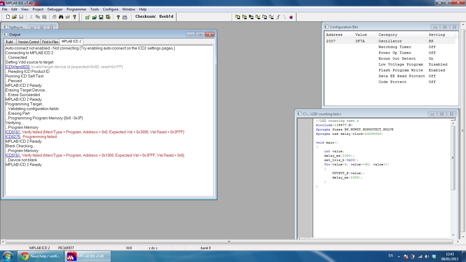

MPLAB gives me a warning and an error
Warning:
ICDWarn0020: Invalid target device id (expected=0x4D, read=0x1FF) Error:
ICD0161: Verify failed (MemType = Program, Address = 0x0, Expected Val = 0x3000, Val Read = 0x3FFF)
I’ve been looking around through the internet for similar topics but I can’t seem to figure out what’s wrong. What got me really confused is the fact that I bought a new PIC just to try and see if it got fried, and the first time I tried to program it, it worked. But the weird thing is after being programmed once it started the same problems as the previous PIC.
I also tried to set the memory locations as manual like some forums suggested but nothing changed.

Warning:
This means that the chip cannot be seen.. The ICD knows there is something there but not a pic16f877. Check that the connections for programming are correct otherwise the pic may be duff.
If its a new chip then it must be connections... Are you sure the correct device has been set?

It seems that it does not actually erase what is on the PIC although it says it was succesfull.
MPLAB ICD 2 Ready
Erasing Target Device......
Erase Succeeded
MPLAB ICD 2 Ready
Blank Checking......
Program MemoryICD0161: Verify failed (MemType = Program, Address = 0x1000, Expected Val = 0x3FFF, Val Read = 0x0)...
Device not blank
MPLAB ICD 2 Ready
Programming Target......
Validating configuration fields...
Erasing Part...
Programming Program Memory (0x0 - 0x38)
Verifying......
Program Memory
ICD0275: Programming failed.
MPLAB ICD 2 Ready
Oh!!! Your'e gonna have to check connections.... Everything looks tickey boo...

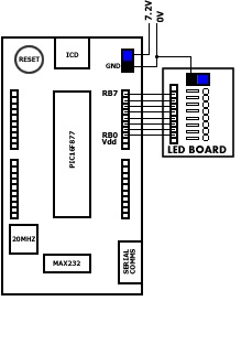

its something custom made from what i can tell,here is a schematic for it...
If the PIC is in a socket (1) check the IC orientation, (2) confirm no pins are bent under, (3) confirm IC is seated fully in socket.
so is it safe for me to just rotate the PIC around just to check if that works??because i don't really know where each RJ11 wire should connect to the PIC this is the only way I could check the orientation of the list...
No! Alec means check the orientation first.... Is it possible to disconnect the two top LED's while programming? They may be affecting the programming stage.
i tried programming it without the LEDs connected all together and it makes no difference. To be honest i noticed that initially when plugged in all the LEDs are lit and once a connection has been established the 2 1st LEDs turn off and play around randomly every time a procedure is in place.
Have the LED's got resistors with them?
I'm trying to eliminate the possibility of the LED's damaging the port.
No. Pin 1 of the IC is identified by a small circular dent in the top of the IC. The pins are numbered counter-clockwise. The circuit board or socket should have some marking to indicate where pin 1 should be placed.
We can't see any wires from here!
