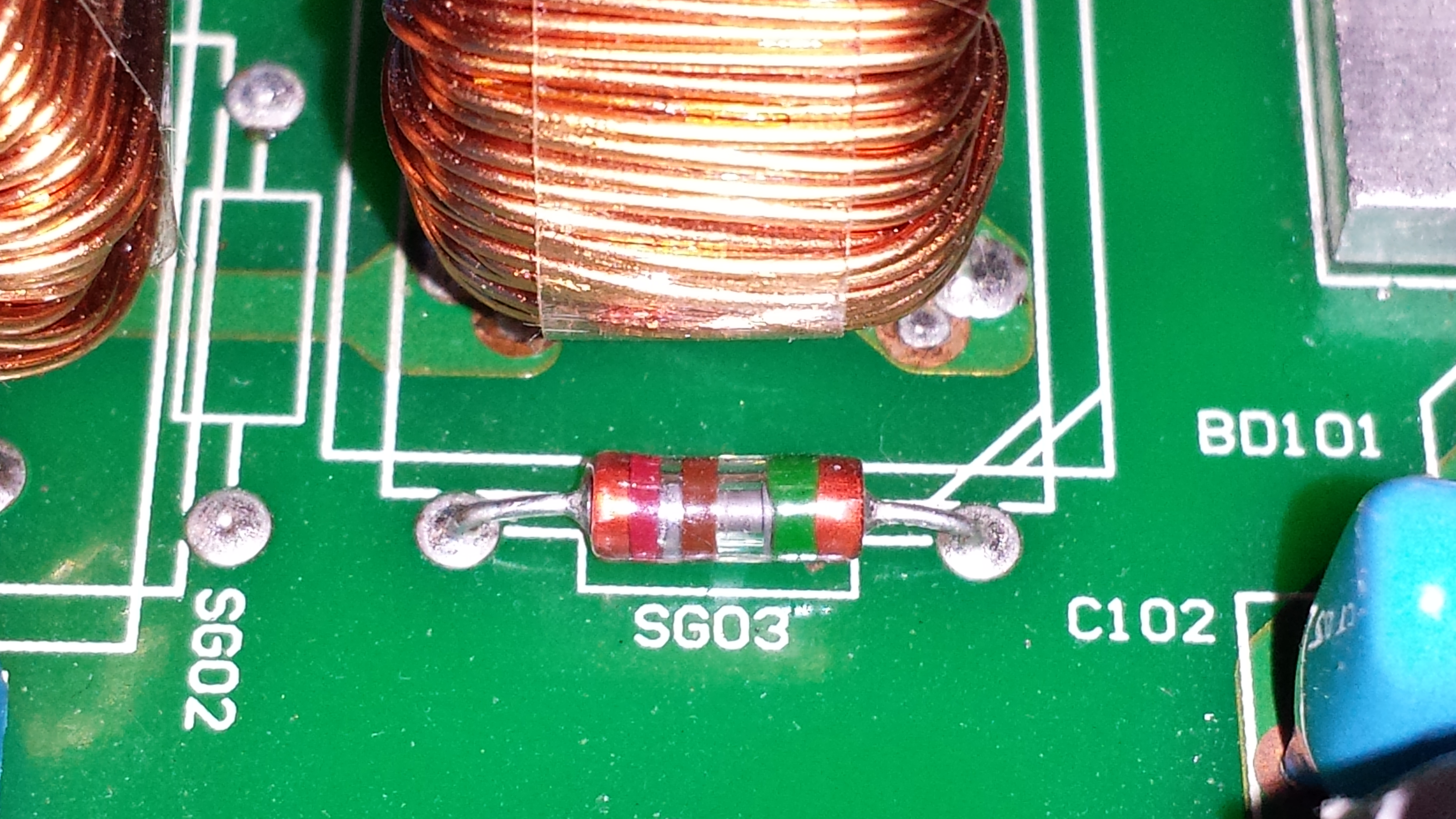

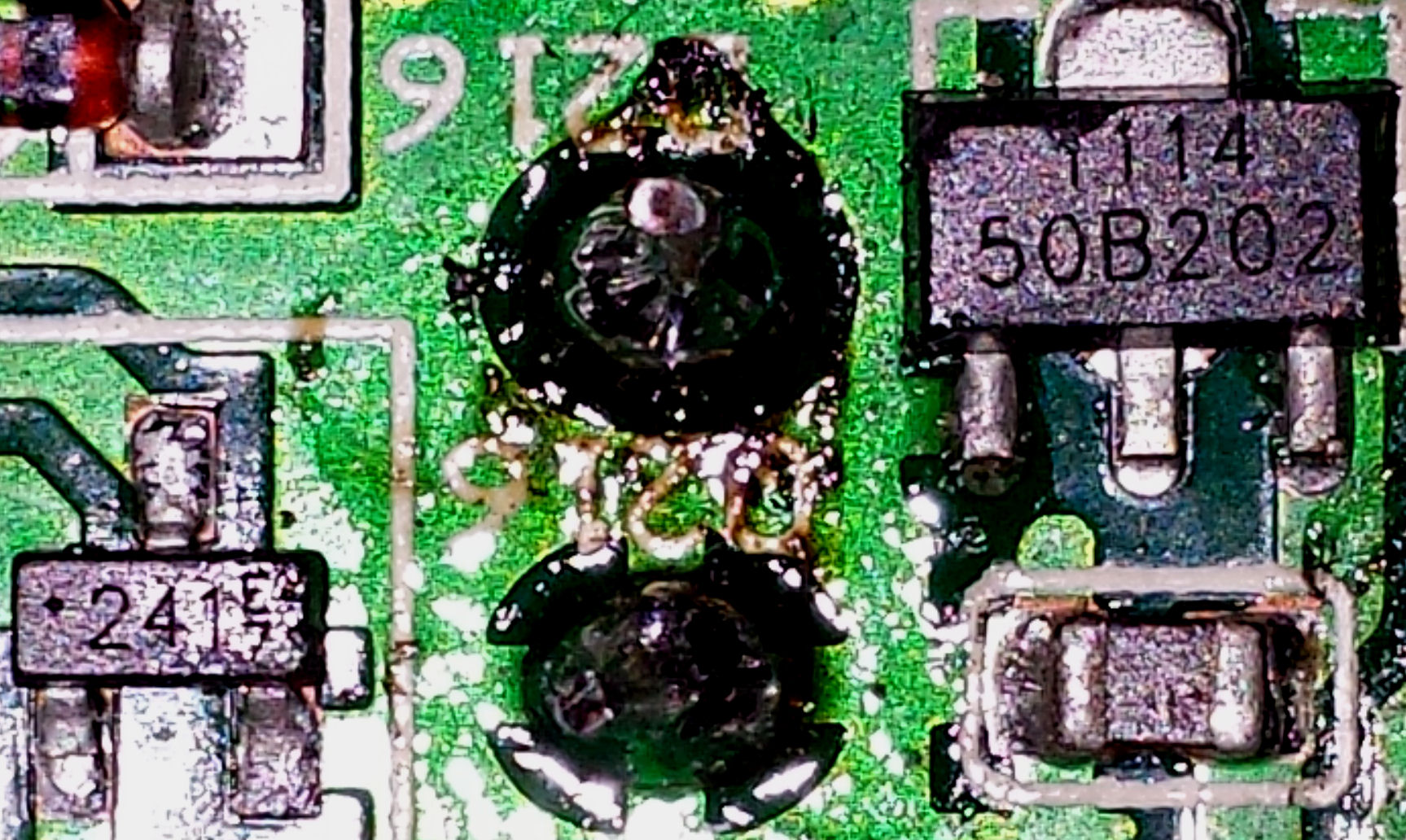

A few things on this board as I'm trying to find if anything is shorted.. they seem to be all SOT parts.
in the first pictures the parts that say M3A and M4A
The 2nd picture:
241 & 1114/50B202
And the last one what is SG03?

Well you see here is something.. a SOT with the markings 241.. my catalog says that's a Zener diode SOT346 but when I look up the part number from the catalog it's saying it's a voltage regulator, and only has connections of 2 of the 3 pins but when I check mine I have continuity on all pins and it acts like a diode by only allowing the current to pass one way.

SG03 is a spark gap. Very unlikely to be faulty.
You can do a rough test of the transistors with a multimeter. They should look like two diodes back to back - npn looks like common anodes, pnp looks like common cathodes, where base is the common point. Should look like open circuit between collector & emitter. Beware of false readings when testing in-circuit due to other components.
It's just two electrodes separated by a gap. When the voltage across it reaches a certain level, it arcs over, protecting the circuit it's connected to.
