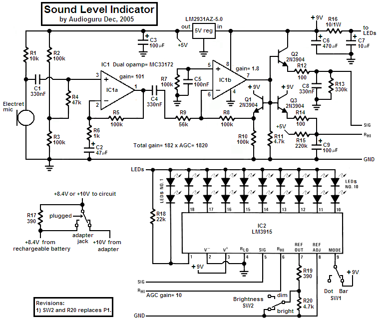

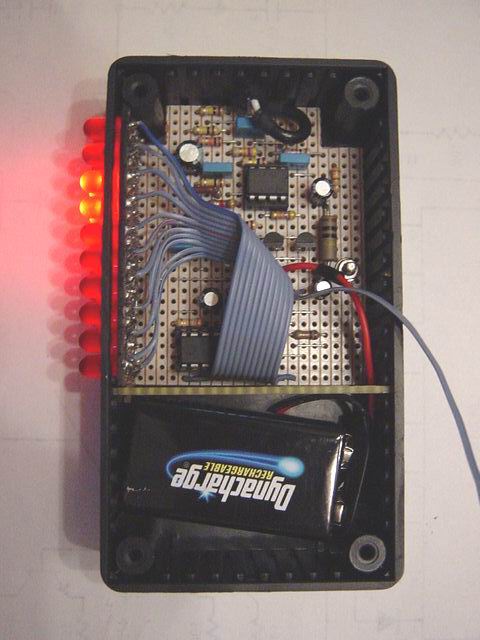

I designed and built my "Sound Level Indicator" project 9 years ago and it has operated continuously 24/7 ever since. Its original 9V Ni-Cad rechargeable battery failed after a few years and was replaced by a Ni-MH 9V battery. I hardly ever use the battery, just to demonstrate this project to people who have not seen it before.
When sound levels are low, its gain is 1820 times and when levels become high it reduces the gain to 182 times. Then its total range is 50dB, from fairly quiet to fairly loud. It shows all audio frequencies because it has no filters. The bass beat in music and my dogs barking are the strongest sound levels it shows.

I read all posts again and the vision gets clearer. I'm actually starting believe that this could succeed.
Your scheme look a lot like the professor gave me! Damn it, this looks good, but I have a question - In that picture where at each pin LED is attached, could I attach there like let's say 10 LED's? Is that possible?
Thanks for sharing of course! :)
A red LED is about 2V and a blue, white or bright green LED is about 3.5V. If you use ten 3.5V LEDs in series then the power supply voltage to them must be at least 36V.
I used two 2V red LEDs in series for each LM3915 IC output and they work fine when the battery voltage drops to 5V.

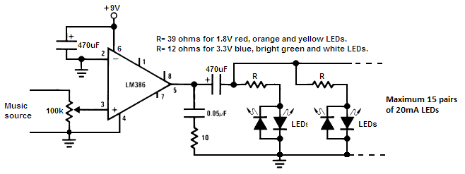

You can look in Google for a simple lowpass filter circuit to feed this LED driver circuit of mine:
