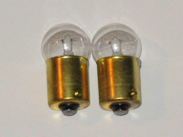

When I look for a replacement bulb I get this:
6V 10 watt.
BUT
The projector claims 30 watt.
So you need 6V at 5A to get 30 watts. I think AC or DC will both work.

Here is the bulb information. I am not sure whether it is an AC or DC powered bulb? It does say here 20 Watts rather than what I stated?

Part Number: RSE-43 *2pcs (yes, you will get 2 lamps for this price)
Volt (V): 6
Watts (W): 20
Filament: C-6
Description: BI-PIN
Base: G4
CT Kelvin: 3000
ANSI CODE: ESB/FHN Lumens/CP: 280
Life (H): 100 LCL: 19.5
Operating pos.:
ANY
Should not matter. The power line is running at 50 or 60hz. Power is put into the bulb 100 or 120 time a second. It takes a while for the bulb to heat up/cool off. It should not make a difference AC or DC.
If you go to a LED, they stop making light very fast. You will get 120hz flashes if you apply AC. (rectified AC) I think the LED rout is too much work.
