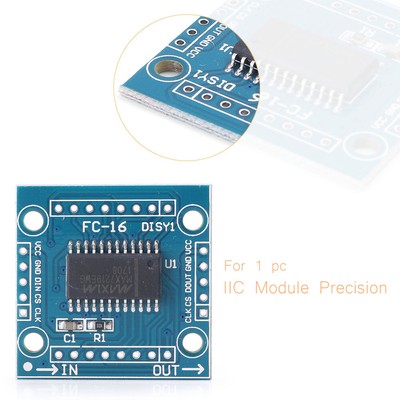

You could use some MAX7219 LED drivers plus normal LEDs to duplicate something like these, but on a curved base, rather than the moulded LED modules; using high brightness LEDs that could be made very power efficient:
Each IC (or ready made PCB module) will drive an 8x8 array of LEDs:
And this is a bluetooth-linked moving message display project using those MAX7219-controlled LED arrays:
