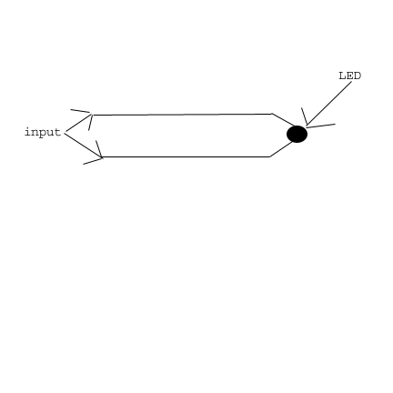

i have decided to use a more simple design [money is a huge issue where i live. i cant find a capacitor or resistor under $1 each ] so i just need to know how to make an led wich already pulses with music brighter in the most simple way posible. i attached a very simple sketch of what i already have.

You show a simple circuit that will burn out the LED whenever it receives a signal because it doesn't have a current-limiting resistor in series with the LED and because the reverse voltage is too high.

i can get a few resistors but i dont need them as is becuase the input i have now can barly light them and resistors are expencive here becuase i have to get them at a hobby shop or drive 40 miles to a city to get to an electronics store. i just want to know how to amplify the signal which only seems to be around .1 volts at the highest to 6-9 volts to run a string of LEDs . so where i had drawn a LED imagine a string of them properly attached with resistors and if you know how just explain how i would basicly add a battery that would add to the signal strength and make my LEDs actualy light up.
In your first post you said you have an output to speakers. An amplifier is what drives speakers and it has plenty of voltage and current to light a few LEDs unless its volume is turned down low.
Now you say that the signal is only 0.1V so it needs an amplifier to increase the voltage.
LEDs need something in series like a resistor to limit the current so they don't burn out.

i already have LEDs wired with resistor perfectly and the reason the output speakers have no power is becuase they are from a dollar store and run off the power in a headphone plug. all i need is a way to add power across the LEDs without blowing the speakers up. i already have my circuit built but the power level is just to low. and like i said erlier all the circuits you posted before would cost me either $20 in gas plus the parts or $100 at the hobby shop i could buy them at. i need a way to do this with just a few parts if possible. I am not rejecting advice im just saying it is out of my price range becuase of this stupid farm town i live not having a proper electronics store.
