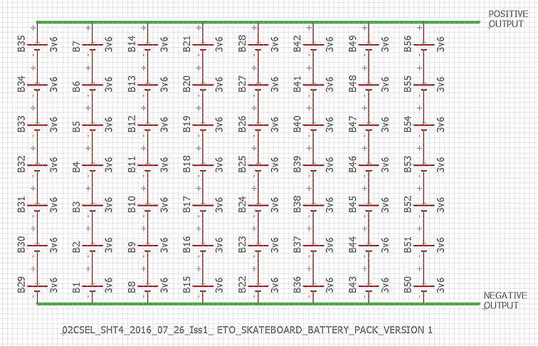

My skateboard originally had 2 12V 7Ah lead acid battery's connected in series making 24V, and the motor is 24V 400W rated.
My new battery pack is total 56 cells 7 in series and 8 in parallel.
I want to charge the complete pack at once simply by connecting 2 leads from one charger, like e-bike charging, so i will try the charger that i linked earlier, with the ebay BMS board and see how it goes, i think that this BMS board will do just fine with limiting the voltage to 4,2 V for each of the 7 groups, like balance charging.

tcmtech, this is my understanding of how the battery pack is wired up. Notice that none of the batteries are in parallel. But in view of what you say perhaps this diagram is not complete and there are connections running horizontally so that the individual batteries are in fact wired in parallel.

That schematic from spec is exactly how i made the battery pack.

If that's how you plan to wire your battery bank you will need a charge controller board for each string of cells whereas if it was wired with each group of cells parallel you would only need one charge controller.
Each set of 6 - 8 2000 mAh cells works as a single 12,000 - 16,000 mAh cell.

The battery in post #28 has 56 cells connected with 7 cells in series in each string (vertically) and it has 8 strings. The balancing connections are not shown. All the cells should be connected in parallel (horizontally) so that they all will have balanced charging.
Unless there is a BMS nodule for each stack of 7 cells which would be normal and what I had envisaged. The battery management system specified by the OP only has a balance current of 55mA maximum, so placing 8 cells in parallel and using a single BMS is not really a practical proposition.
(It is not necessary to describe the circuit of post #28. The schematic is quite clear and, as they say, one drawing is worth a thousand words.:))

With this proposed layout every single string of cells has to have a dedicated charge management system which adds a lot of cost and physical bulk to the whole design which is totally counter productive to being integrated into a powered skateboard.
To me for a battery pack this large made of that many cells something like this is what I would be looking to design things around.
Since it is an ebay ad, the SKYRC charger has no detailed spec's but it might work fine. It has switches on top that might accidently be bumped into the wrong position (LiFe or too high a charging current) but they can be fixed with a cover glued over them.
Since it charges only a single string of cells then the cells in the battery of 56 must all be connected together horizontally.

Given the mix and match of cell ages and mAh capacities, I don't see any other practical way to make charging that many cells together work from one charge control unit.
