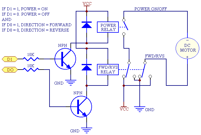

in this circuit FWD/RVS relay is shown with 2 separate contact pins and 2 separate NC and NO pins...
i wanna ask whether they are using 2 relays with one transistor or configuration of relay is just like that internally..?

It's two relays, and clearly shown as such. One is used for ON/OFF and the other for reversing.
It's a DPDT relay, also called a 2 pole changeover, again it's clearly marked as such, by the dotted line from the coil to the contacts. It's a standard relay!.

hmm...in this case if i dont use that relay...can i use two simple relays with one transistor?
You could use two single pole changeover relays - assuming you already have them? - if not you may as well get the correct relay, like I said they are VERY common.

im not been able to switch two single pole relays with one transistor(2n2222).
What are your base drive voltage inputs, if they are +5V, its most likely that with a 10K base resistor you are not driving the 2N2222 into saturation, when you have two relay coils in parallel.
Whats the supply voltage to the relays and what is the coil resistance?

Connect a 9V relay to a 9V battery. Then hold the relay's wires in one hand and disconnect the battery. You will feel a big shock (don't use both hands or it might kill you).
The voltage when the relay is disconnected might be hundreds of volts that could destroy a driver transistor. Adding a reversed diode across rhe coil clamps the voltage spike to 0.7V more than the positive supply voltage.
Doesn't it clamp it to 0.7V below the supply not 0.7V above the supply?

hi hero,
The 'spike' at the collector is postive going, wrt Vcc line, so it forward biases the clamp diode into conduction, thats why its clamped to Vcc + the Vdiode fwd drop.
