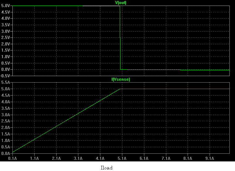

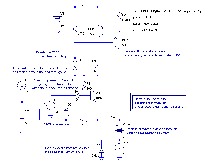

I cobbled together a little simulation in SwitcherCAD for this problem. The values for R1 and Rsc are shown as .params. As was pointed out, this is hypothetical, and doesn't use real parts that you can buy or steal.
Ron
Hi Ron,
It looks like your sim is using 0.228 ohms for R2{R1} and R3. Then with 1A through the 7805 regulator the voltage drop across R2{R1} will be only 0.228V and the booster transistor Q4 won't be anywhere near being turned on.
The 7805 must pass 0.6V/0.228 ohms = 2.63A for the booster transistor to begin conducting, and when the booster transistor reaches a collector current of 4A with a Vbe of 1V, the 7805 will have 1.912V/0.228 ohms = 8.39A through it! :(
audioguru said:
Hi Ron,
I should have numbered the resistors differently.
{R1}=3 ohms=the value of R2. (.param R1=3)
{Rsc}=0.228=the value of R3. (.param Rsc=0.228)
Ron
Hi Ron,
Don't you argee that if {R1} is 3 ohms, and if the regulator has 1A thru it, then the voltage drop across {R1} is slightly less than 3V and your booster transistor Q4 would be turned-on so hard that the other transistor Q3 would current-limit? Then the Rsc would have about 0.9V across it and wouldn't you know, have nearly 4A through it! :shock:
But it doesn't work that way because Vbe of Q4 plus the voltage across Rsc reduces the voltage across the 3 ohms resistor, reducing the current in the regulator to about only 633mA. :lol:
Hi Len,
The additional current (1A-633mA=367mA) will flow through Q3, if Q3 is robust enough to carry that current. It might be better to make R2=2.2 ohms, which (in my sim) increases its max current to about 856mA, and reduces the max current through Q3 to about 104mA. You can't cut this too thin without running into component tolerance problems, but then this is just an academic exercise.
If anyone wants to try this, here is the SwitcherCAD file. I have posted it as a text file, because the forum doesn't accept .ASC files. Save it to C:\Program Files\LTC\SwCADIII (or wherever you keep your schematic files) and rename it with the .ASC extension.
  • scp_reg.txt
Hi Ron,
I changed the file type of your sim file before downloading it and got SwCADIII to open your schematic. I watched it run a few things but it is different with R1 = 2.2 ohms.
Do you think the Current limiter transistor is active with a 5A load?
If this is the case then I am giving my appologies to Russ and Morgen. :oops:

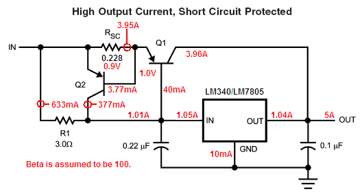

Do you think it looks like this:
audioguru said:
Hi Ron,
Yeah, I think that you were missing the fact that Q2 will conduct when it limits the voltage across Rsc. It will supply the difference between The regulator's current and the current through R1.
