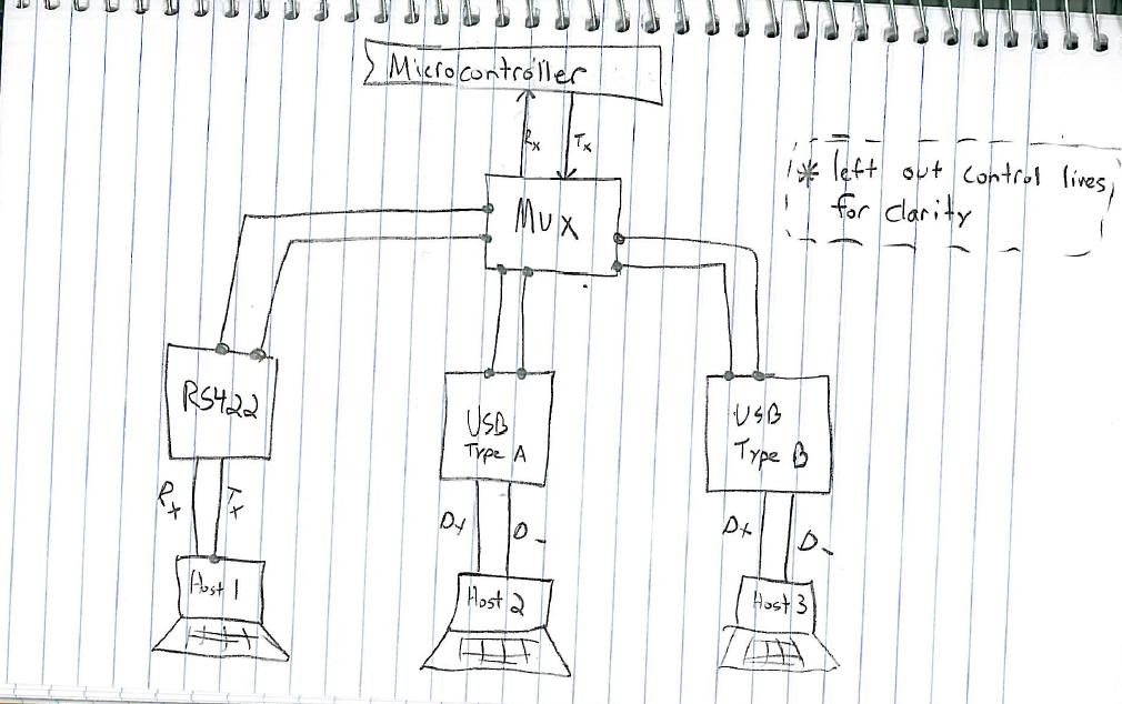

Hello,
I have attached a file which depicts the type of Multiplexer I'm looking for. It takes an 8051's(microcontroller) transmit and receive signals and needs to route to three different chips.(RS422, USB Type A, USB Type B) I want the mux to only route it to one of the chips at a time using a couple control lines.
I have searched digikey..mouser and haven't found what I'm looking for. Is there anything I'm missing. Seems like it's a pretty simple one?
ps. This is a 5V system which is sending keyboard/trackball data so the baud rate is extremely slow. The chips will connect up directly to each host.
Thanks!

so I have figured this out using 74hc4066 to get what I need done.

Look at the HEF4051... 52 & 53 analog selectors.
