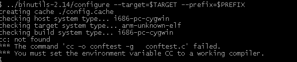

need advise to build GNU tools for ARM
tiny12
I have untar all the gz
$ tar xzvf binutils-2.14.tar.gz
$ tar xzvf gcc-3.23.tar.gz
$ tar xzvf newlib-1.11.tar.gz
$ tar xzvf gdb-6.0.tar.gz
under /home/test
according to your document
$ cd <---- this go back /home/myself
$ mkdir build-binutils
$ mkdir build-gcc
$ mkdir build-newlib
$ mkdir build-gdb
$ mkdir install
$ export TARGET=arm-elf
$ export PREFIX=`pwd`/install
$ export PATH=$PATH:$PREFIX/bin
so I must stop here for further advise. "should this be cd /" or what the
above directory under which "TOP directory"
You need to configure and build the binutils first:
cd
cd build-binutils
../binutils-XXX/configure --target=$TARGET --prefix=$PREFIX
replace the binutils-XXX with the actual path to the binutils that you untarred from the archive file.
I have deleted all the untar files under /home/test/ and re-shuffled all *gz
files to /home/myname/
and untar them under cygwins in multiple sessions since their folders are
under different directories.
after the three export stmts
export ....
export
export
I also set | grep prefix
and I also do the set grep and make sure
myself at the /home/myname/install at the prefix.
I then followed in page 3
cd build-binutils
../binutils2.14/configure --target=$TARGET --prefix=$PREFIX
I then read the configure file and readme under binutiles2.14
I discovered this lines in configure
# CFLAGS is not in ac_cpp because -g, -O, etc. are not valid cpp options.
ac_cpp='$CPP $CPPFLAGS'
ac_compile='${CC-cc} -c $CFLAGS $CPPFLAGS conftest.$ac_ext 1>&5'
ac_link='${CC-cc} -o conftest${ac_exeext} $CFLAGS $CPPFLAGS $LDFLAGS
conftest.$ac_ext $LIBS 1>&5'
and the setenv in the readme. I have tried every possible combition. I failed.
can u help?

Ok, the problem is that you dont have a compiler already installed. You need your cygwin gcc to build a gcc arm cross compiler. Just download and install the binutils and gcc for cygwin. Then you will use those tools to build the arm toolchain.
