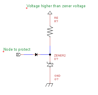

There is a certain node in my circuit at which I want to limit level of voltage. The voltage at the node is pulled up by a resistor with an amount of about 1MΩ. I want to use a transistor to ground this node if excess voltage is delivered.
But I don't want to pull-down the voltage at normal operation (i.e.; the node voltage is below upper limit).
For this purpose I need a transistor which has an off-state resistan much higher than 1MΩ.
Which transistor type has the highest possible off-state resistance? BJT, FET or MOSFET?

Either a FET drain or a bipolar transistor collector look like a reverse biased diode when off. They typically have off-leakage well under a µA at room temperature and at voltages some below their maximum rating.
My question is how you are going to sense that the voltage at the node has risen above spec without loading it down. You could use a pre-biased zener and diode to accomplish this. The zener voltage would be apx 0.7 lower than the desired clamping voltage:
There is a voltage divider in my design. A 1MΩ (at high side) and a 10kΩ (at low side) are connected in series. 10K is connected to ground and 1M is connected to 500V. So the voltage on 10K resistor is only 5V. If it goes above 5V, I will use a comparator to swith on the MOSFET to ground the voltage on the node where 10K and 1M resistors are connected.

Since the current will be low, you could simply rely on the input clamping diodes of the ADC or whatever is connected to the node. Or you could get fancy and use an OpAmp as a voltage clamp. The OpAmp has the same speed issue due to it's slew rate so some overshoot will occur:
