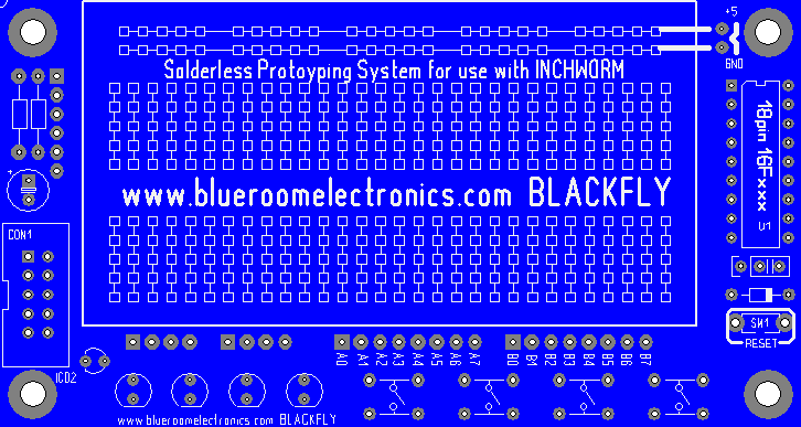

Need a name for this PIC solderless prototyping system.
The idea just came to me this morning, I drew the layout before the schematic. Very simple design but should prove usefull. I may change the bottom switches to the narrow 2 pin types to allow for a little more room for the silkscreening.
I could also squeeze the switches together and maybe add who knows...
I could even make a little space for a few servo connectors, small enough to mount on a robot chassis...
I've called it Blackfly for now, suggestions for a better name? Opinions?

Why its not holes on the PCB (could be I suppose) but a small 350 hole solderless breadboard.

It definitly needs more, anyone that is even cursorily into electronics will outgrow a device that simple inside a week.
I like it. That is the protoboard I have been looking for. I sit on the floor, stuff the parts around the PIC on a protobaord, then clip on the programmer/icd to berg pins.
Of course you will, it's not designed to be a final project but something you can get your feet wet with.

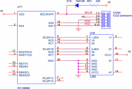

I've added a L293 to the design. Uprated the PIC to your choice of a 16F886 (NEW) or the more powerful 18F2525 with the free C compiler.
Real 2xPWM on the L293s Enable pair. You can run the tamiya dual gearbox with it. I may even build a chassis with 4xAA.
Another feature is a pair of servo connectors and a pair of opticals for wheel rotation. Leaves lots of I/O for the user.
Not sure if I'll add rs232... but I'll leave the pins available. As well as the I2C stuff.

I would think that is a great board for intermediate users. They can pick their PIC, wire it how they like over and over. Then move the design to PCB.. Other than higher end PICS, I think "blackfly" is great.
Were firefly and others are limited to where the pins are setup. It still have a user connector for small projects.

Well Microchip keeps providing ideal PICs for certain jobs. The 16F690 (same as the PICKit2 PIC) seems almost perfect for motor control. It's smaller 20pin (yep the Firefly socket supports 20pin just use the 8/18 setting) and has the PWM channels perfect for running the L293. Good for controlling steppers, motors and small relays.
I'll save the 18F2525 for the next project. I can probably have the PCBs done for this robot controller done before Christmas.
