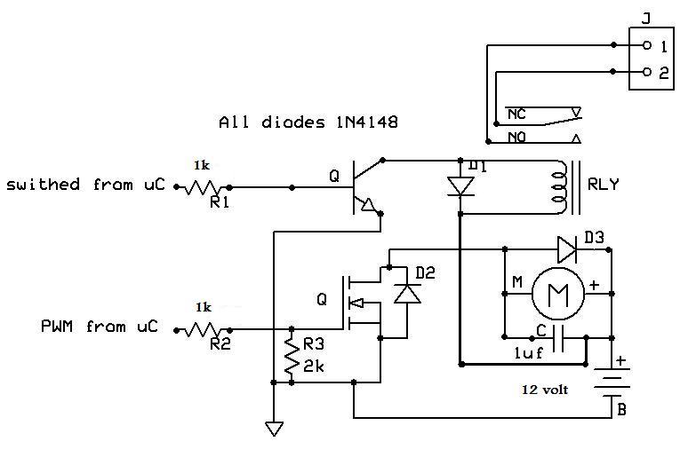

If your close to the shack I would get a Arduino uno there cheap seeing they have all you need to program the chip on one board and there simple to use if your new to this and even simpler if you no C. They also have a 5 volt relay that can switch 120 volts from the mains.
You can pwm the motor too.
$34 for https://www.radioshack.com/product/index.jsp?productId=12268262&ab=MicrocontrollerLP
$5 for https://www.radioshack.com/product/index.jsp?productId=2062480
$3 for https://www.radioshack.com/product/index.jsp?productId=2062618
And a 2n3904 a diode 1N4148 and a resistor or two.
Or check Digi key or Mouser or Newark
I would go with the shack this time don't need much.
If you want I'll post you Circuit
The relay can handle 1 amp

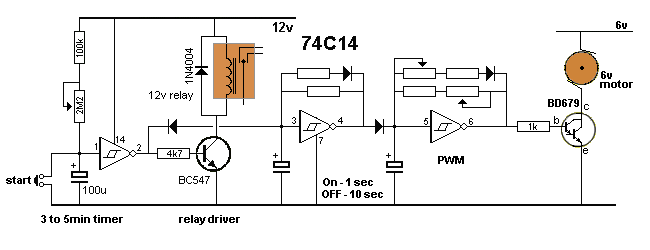

You can do this with monostable 555 timers.
Like this;

Here the Op something to work with

Here's a simple circuit I put together in 2 minutes:
Spend another minute to fix the feedback error - the diode from pin5 to pin2 should be removed
