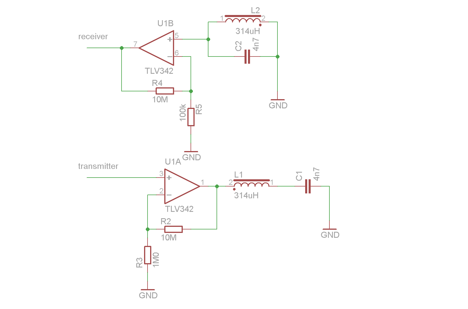

I’d like to ask you who are more experienced with ferrite antennas and LF transmissions for a help with the following problem. I have a circuit for near-field magnetic inductive communication consisting of a microcontroller generating a square-wave signal (carrier, 131 kHz). An amplitude modulation (on/off keying) is used for the communication. A schematic is given in the figure 1 (schematic_transceiver.png).
The signal is fed into a non-inverting op amp U1A. The output from the op amp drives a series LC circuit, the inductor L1 being a ferrite antenna. Receiver is similar in that it is a parallel LC circuit whose output is fed to another op amp U1B. Both op amps have an asymetric power supply (Vdd = 1.8V and GND).

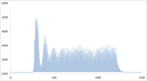

The signal transmitted is a pulse of 128 cycles of the carrier frequency. A received signal is shown in the figure 2 (signal.png).
The horizontal axis correspond to samples taken by an ADC. The vertical one is an arbitrary number corresponding to voltage (the higher the number on the axis the lower the voltage; GND = 5450, Vdd = 3500). The signal is rectified by the second op amp, therefore it is a half sine wave. I would expect to see an envelope of the received signal similar to the transmitted one (a square pulse) except for an exponential attack and decay of the envelope. However, as can be seen in the figure, there are other oscillations at roughly 1/12 of the carrier frequency, mainly at the beginning of the pulse. Could anybody provide an explanation of the fenomena and/or suggest what should I do to remove/decrease these dramatic changes in the amplitude of the envelope? Any suggestion is welcome.

I get the impression that you expect those op amps to operate as linear amplifiers. In that case, your DC bias is wrong. When operating from an asymmetric DC supply of 1.8V and ground, it is necessary to bias the feedback network to mid-VCC so that the output voltage centers at that same voltage and so that the output swings around that center voltage. To fix this, disconnect the bottom of R5 from ground and connect it to 1/2 of VCC (or 0.9V in your case). Do the same for R3.

To RadioRon: Yes, you're right. The op amp is intended for asymetric power supply. Actually, if I did what you suggest I would get a full signal from the receiving op amp, not the rectified one. However, would it have an impact on the "slow" oscillations? I don't see how that would change.

Without really delving too deeply into it, I'm wondering if the transient behavior that you refer to as the slow oscillations is simply either the transmitter or receiver op amp suffering a shift in bias point as a result of the presence of the rectified signal, which carries with it a different average dc voltage than was present the moment before the transmission occurred. In other words, the DC operating point of the op amp is shifting during the pulse, but with a relatively slow higher order response (ie. underdamped).
If so, one way to deal with this might be to reduce the values of your resistors by three orders of magnitude to reduce the time constants of the circuit.
