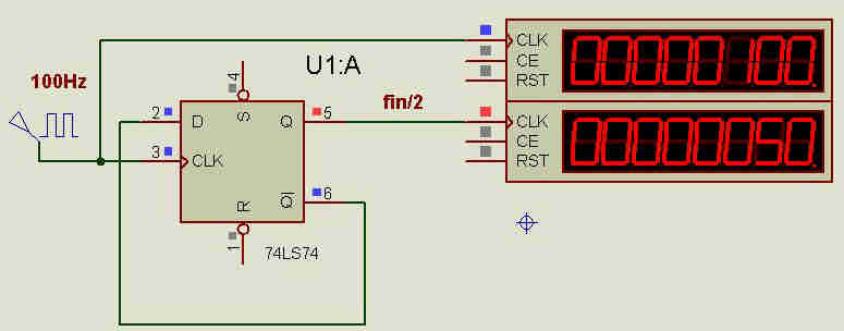

Surely you have a spare flipflop lying around. Something like a 7474 or 4013.
Hi Mike,
why not supply the wiring? :)
Here it is.
(Clock in 100Hz, out 50Hz)
Hans

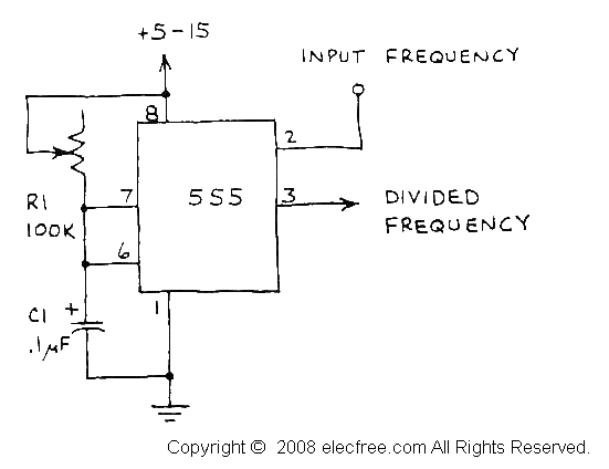

This is what on offer from the NET. I have not tested it and have no idea if it works or not.

Just use a flipflop, much more stable as 555 has analog parts.
A 555 as a divider is a bad solution in a digital clock.
It will work if timing is 100%. Thinking of the cap it takes a lot of experiments to get it right.
I wouldn't recommend that kind of circuit for a frequency divider.
What do you mean by 100% timing?
The circuit is a simple one-shot triggered by the input frequency. As long as the one-shot timing is longer than the input one cycle period but shorter than two, the circuit will work.
