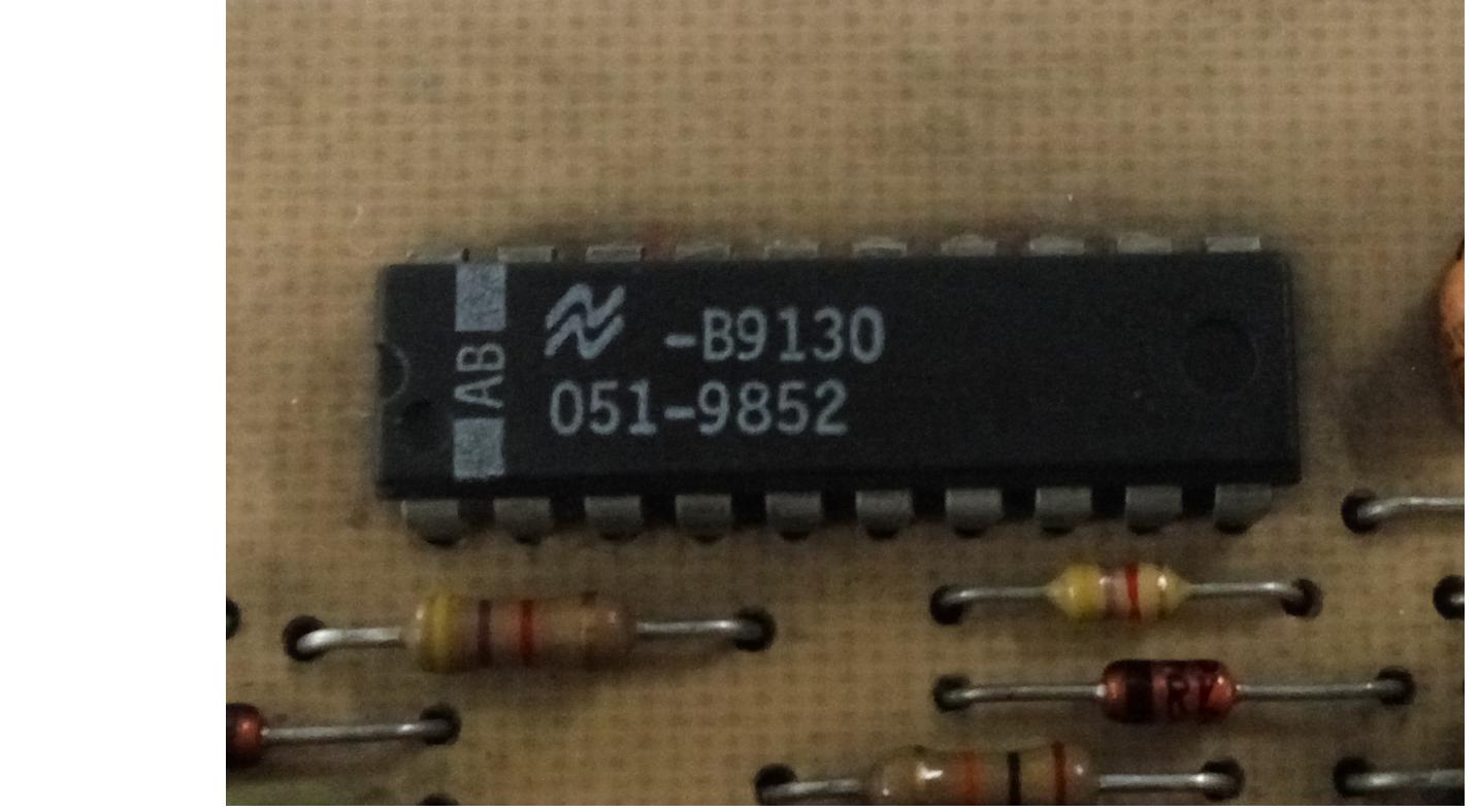

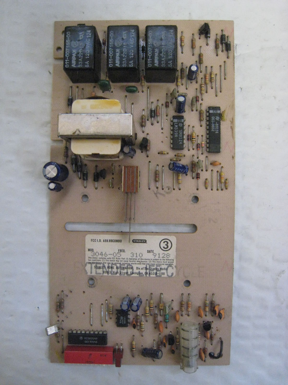

Please help to find what is the replacment IC for this old National i have attached at photo.
051-9852
This is for the pcb of my stanley garage opener
Any help will be appreciated

The chip that you show has a National custom number so getting that number part would be impossible.
But we may be able to find a functional replacement, provided it does not have a special function too.
We would need a schematic from the service manual or if you could trace out the printed circuit traces and draw a circuit that would do.
Why do you want to replace the chip though?

I want to replace it because:
Near this ic is the lm339 ic. It warmed alot and the voltage at vcc pin was 2volt.
Replaced the lm78l82 and voltage is 8.2 V. Also replaced the lm339 IC but the pcb is not functional...
Suppose that this 051-9852 ic is off and if replace it will do the job.

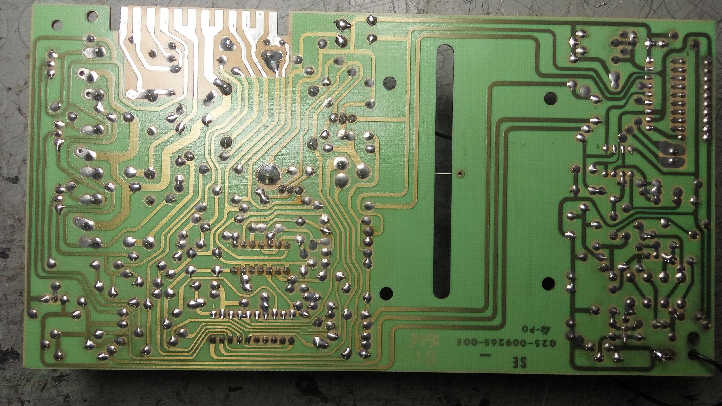

Attached for you to cheack please is the other side of pcb
Thank you alot for helping
I have a feeling its a special.... AB may be Allen Bradley who did motor controllers... If this is the case this is probably a GAL which would need programming... BUT!! references to B9130 yield programmable power supply chip...
I would imagine it's most probably a custom chip, and is a programmable device as well - so the only source would be a direct replacement from the manufacturer.
Interesting it's a 20 pin device, which is fairly uncommon.
Looks very much like the National Semiconductor logo to me.
spec
Yeah, I thought that. The early 20 pin packs tended to be octal bus drivers/transceivers: 74xxx245 etc
