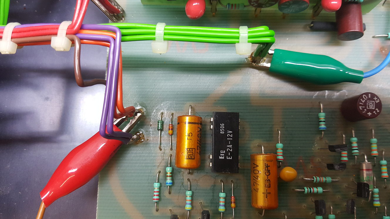

Hello. I don't do amps.. But I have a pre amp that has no output
The dual solid state relay ( I think that is what it is ) isn't turning on.. There is a two transistor darlington pair ( both ZTX214 ) just at the bottom of the picture
Injecting a signal it arrives left channel pin 8 and should leave on pin 5 right channel is on pin one and should leave pin 4.. Pin 2 and 7 are 12v and pin 3 and 6 are ground. Injecting 12v on to pin2 and 7 and it runs... As these seem superflous as the relay should work 24/7... why should I replace them.. I could just bypass... Whats the opinion of the group..
Is it actually a solid state relay?, I would imagine it's FAR more likely to be a reed relay - a Naim is a high quality (and expensive) unit, so you don't want anything in the path that will reduce audio quality - and a simple pair of mechanical contacts is as good as it gets, better than any solid state solution. Another option could be an LED and LDR combination?.
I would imagine it's there simply for muting, perhaps to stop any clicks when you switch inputs etc.
The fault has been traced to a tantalum on the 24v supply.. short circuit.. Which is funny as its rated at 35v but the input is 40v+ and even I know that's not good.
It is indeed a reed relay.. Once the amp is fixed, I will retry.. But I need to map out this reed circuit as there isn't a voltage on pin 2 and that PNP pair is supposed to supply it..

One question.. Now I know what it is.. In the datasheet there is a "dotted" flyback diode shown... Now the diode immediately to the left of the large cap goes across the voltage rail.. Is this a recommendation or is it within the reed relay?
I bought some similar looking reed relays a few months back, and they had an internal diode - so you had to ensure you connected them the right way.
And I've just checked the datasheet for one right near me now, and that apparently has a diode in as well:
I put a 65v electrolytic in... I now have a nice stable 24v... I just need to wait for a TO220 insulating kit as it cannot be grounded to the case..
Worst case.. I'll stick a 12v zener in to supply the relay.. The "mute" is a simple switch on the front that just disconnects the input.. I cannot see ANY circuit that connects to the base of the PNP.. other than a potential divider
