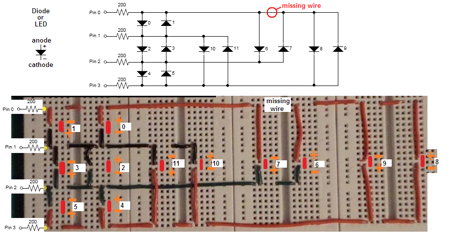

Mystery LED's in Series

I was using a set of jumper wires for everything the last three days until yesterday. I made up my own which you see in the pic.

Here's a copy anyway, you might find something wrong. If it's the board at least I'll know how to wire it on the replacement.

I never use a breadboard so I am guessing about how yours connects.
You missed one wire and have the polarity of every LED backwards.
each row of 5 across is connected to a single conductor.
so any wires in that row are connected.
I added the missing wire, and checked the polarity and everything is reversed now as you listed.

Well just one last comment, I threw some 150ohm resistors on and it's 90% functional.
The combination of pin3+ and pin4- brings up multiple LED's, otherwise is fine.
So I built a 6 LED model to make troubleshooting easier, same 150 ohm resistors.
It only took 10 minutes anyway.
Combination of pin2- and pin3+ produces multiple led's, otherwise works fine.
It's the last two pins in both configurations.
Since that's the furthest LED maybe I need to swap out the resisters again?

Your problem with too many LEDs lighting is caused by too many inputs at +5V and at 0V.
