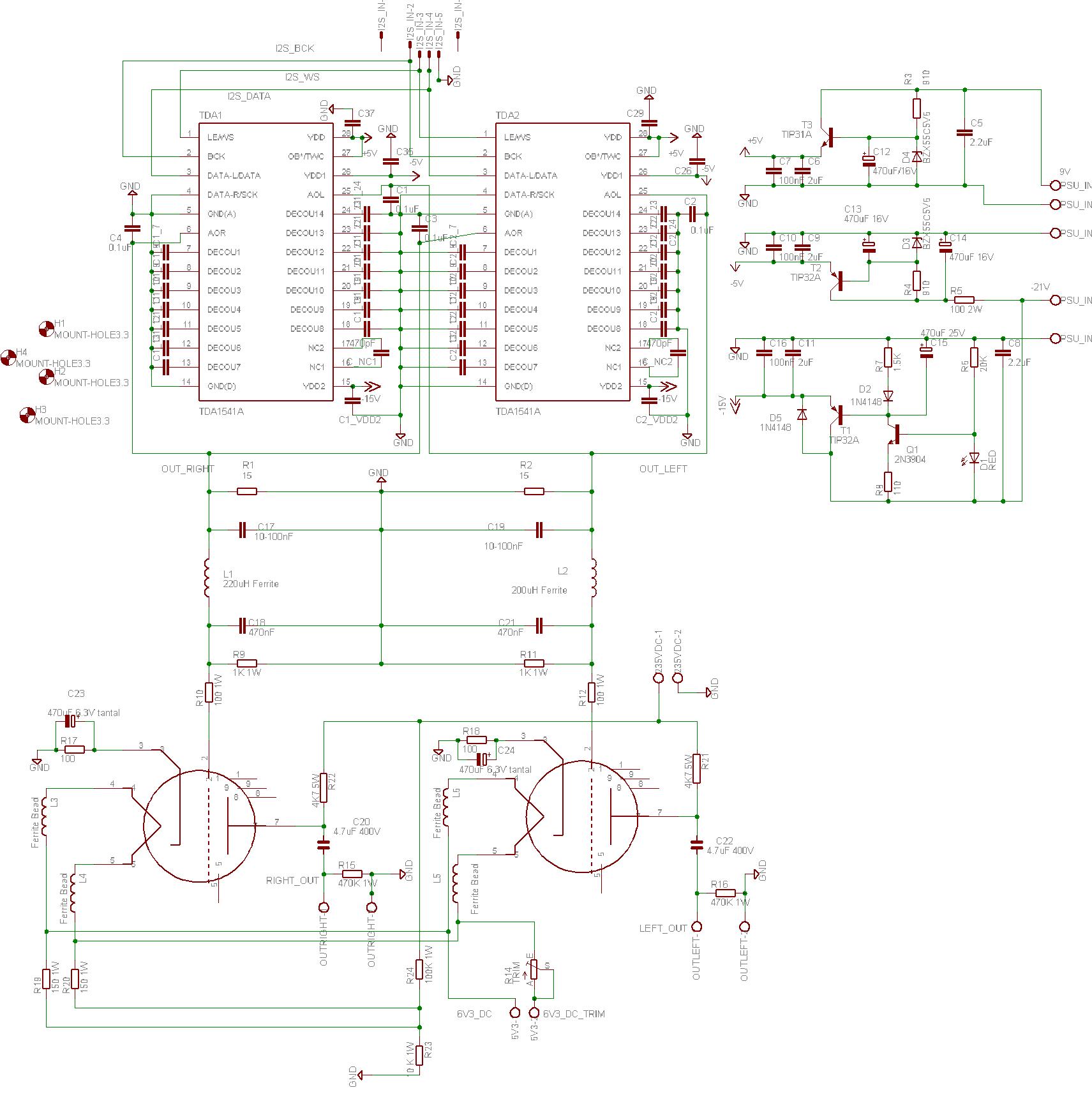

-I do not use the internal DAC of this unit, but I built a DAC with 2 TDA1541A in //,. The protocol of incoming digital data from the unit is I2S
The DAC is using the 6C45PI vaccum tube as output buffer.

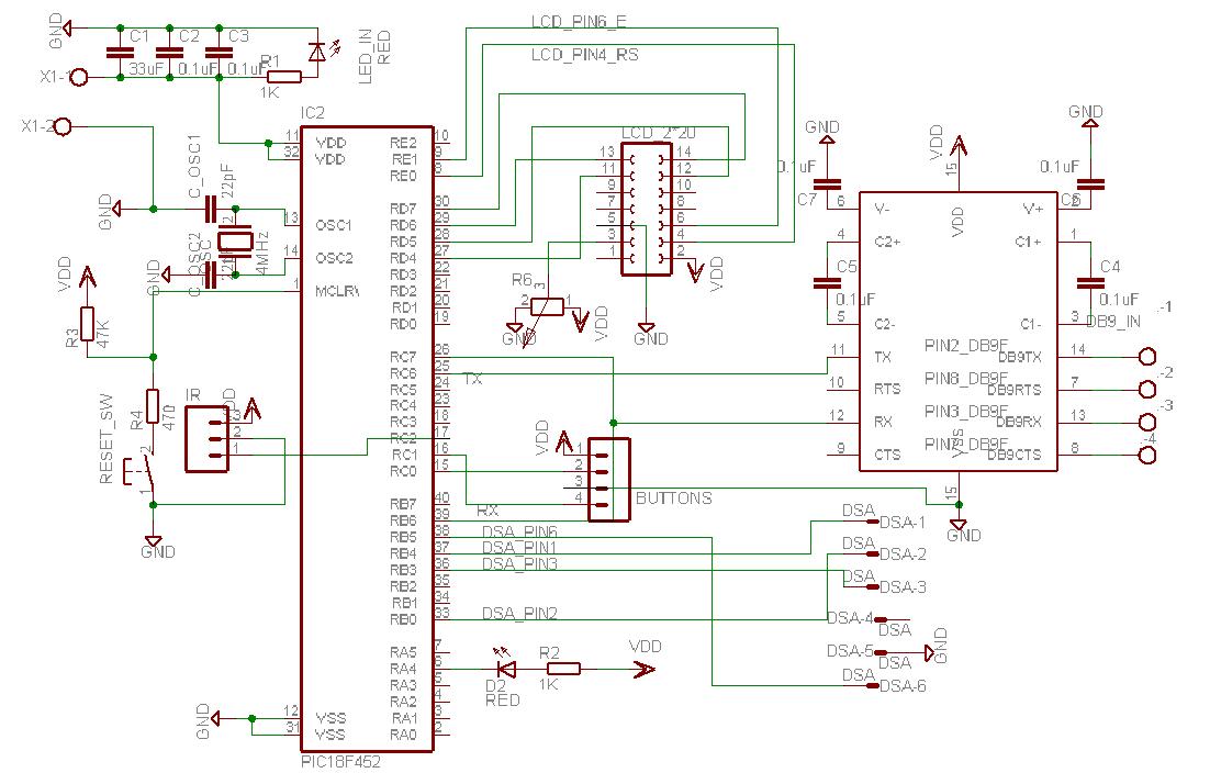

- The controller is based on the PIC18F452. There is a LCD (4-Bits programmed), buttons, IR and DSA interfaces. The DSA protocol is used to receive/send data from the CDPRO2 unit. (take a look at the CDPRO2 datasheet)

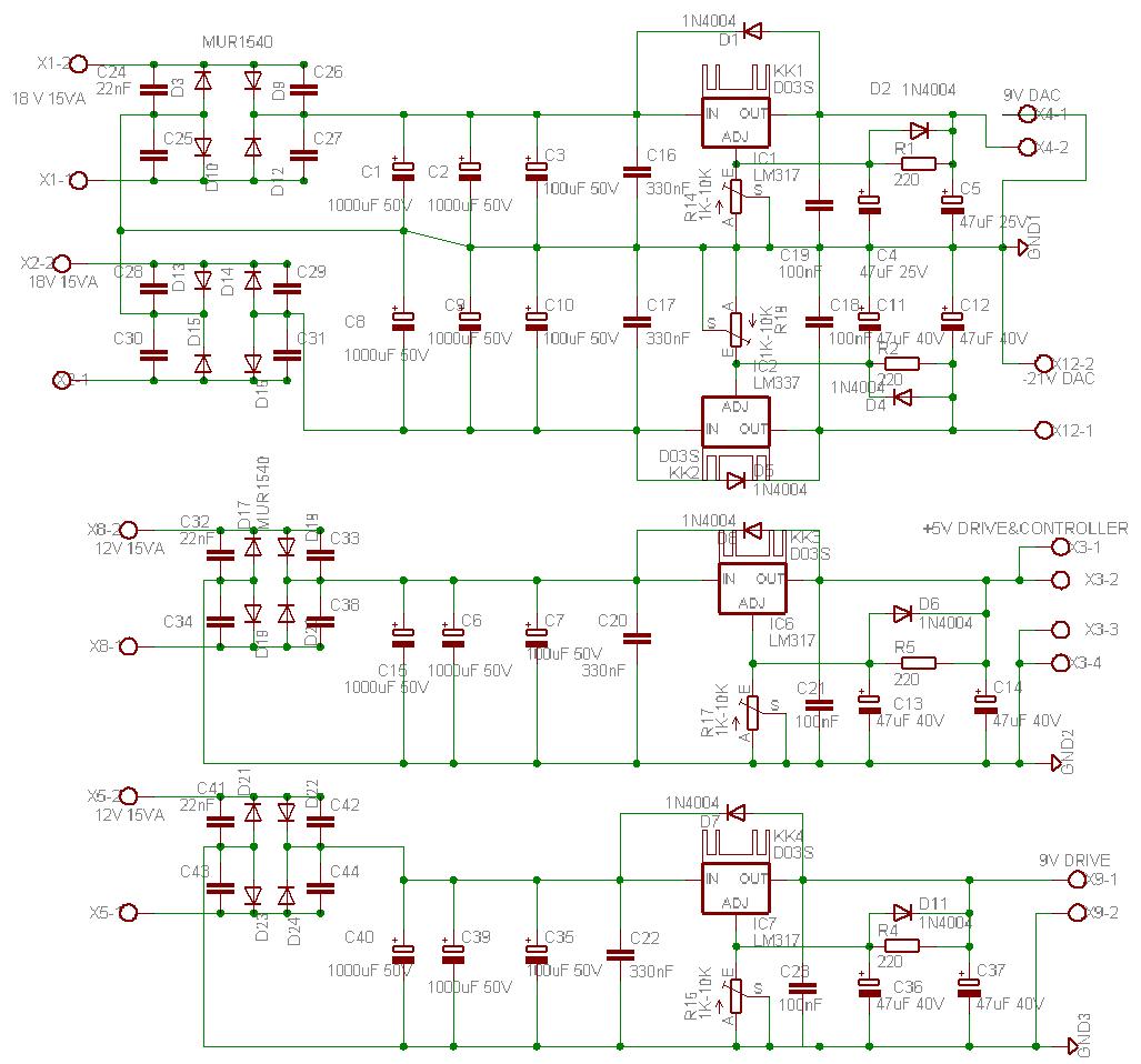

- I built as well as PSU board as I need several voltages :
+5V for the DAC, controller, unit
-5V, -15V for the DAC
9V for the unit.
I didn't completed the PSU for the output buffer so far, let's be patient :wink:
You will find enclosed some schematics and boards.
The schematic of the controller board is still a "draft" as there remains several task to do, for example, dealing with the ON/OFF sequence of the CDplayer.

Hi ZERS,
don't like the look of C 20 and C 22,
are those values correct ?
I assume this unit is to drive a further
tube output unit.
Best of luck with it, John :)

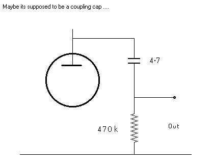

Had another look,
still not happy about the 4.7 mfd caps.
Maybe they are supposed to be coupling caps.
John :)

I agree, john1. In the original schematic the anode voltage sitting on the output...
And the plate voltage... why 235V? The datasheet say max 150V.
I agree as well, the capacitors are drawn in the wrong place, they should be output coupling capacitors. The anode load resistors seem uncommonly low as well, usually these would be much higher - as you say the anode voltage is likely to be too high with those values, I would normally expect to see 100K-470K as anode loads on triodes.
However, the whole idea of adding a couple of pointless valves to a CD player seems strange? - I find the current fad for adding pointless valves really strange, but as least these are wired in circuit!.

You all have right guys , I had posted a "old" schematic but not the up-to-date one...
I deleted the schematic as well as its board from the previous post, but I should have problem with my NET supplier, as I can no longer attach files... As soon as I try, my internet session is crashing :evil:
Will try later... :roll:
As far as the 235V is concerned, the datasheet explains that the tube is class A "polarized" in the middle of its linear curve. So it consums current... After figuring out some electric rules, I found 235V, voltage that I have seen as well in other DIY projects using those vaccum tubes.
Sorry my english isn't good, I could not clearly explain you why 235V, but be sure that this is the correct voltage, as well as the 4K7 5W resistor :P

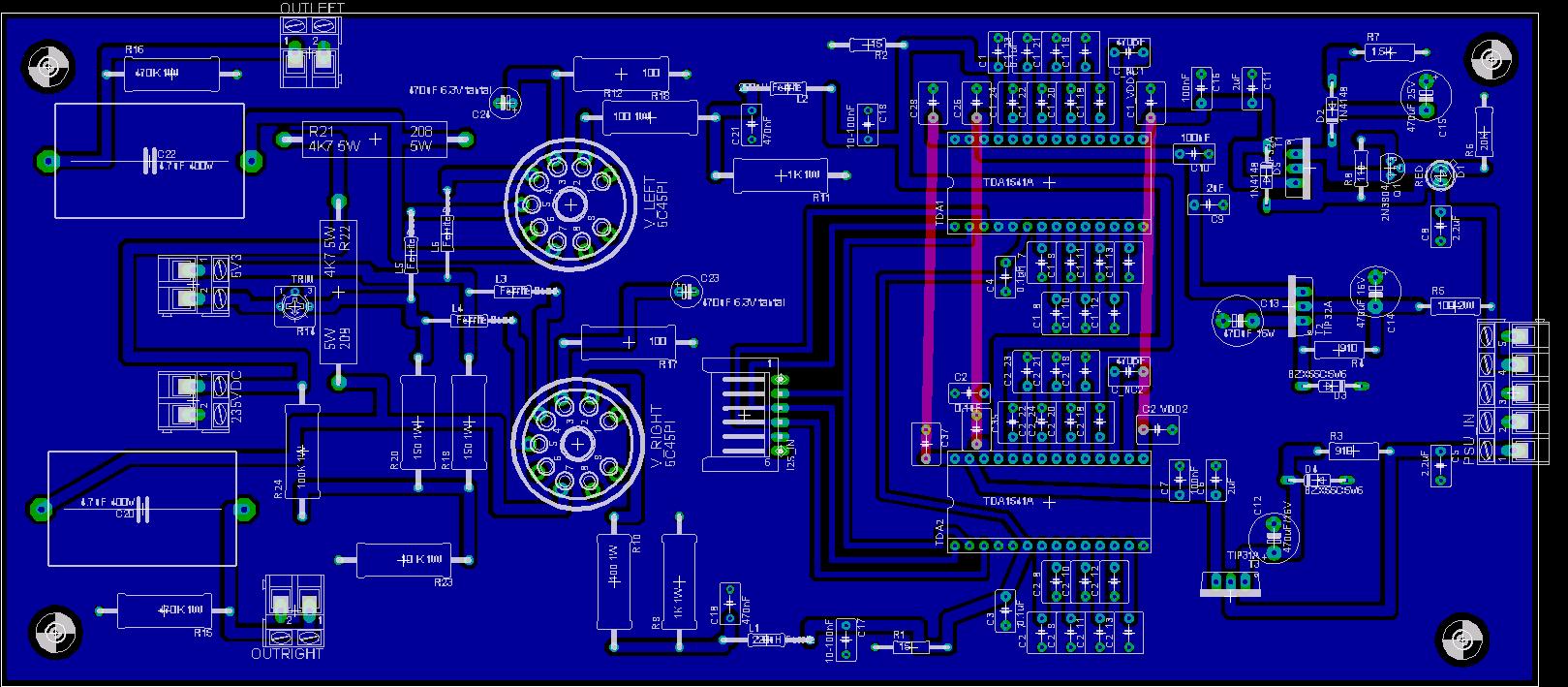

Hi Zers, Exo, Sebi, Nigel,
Thanks for the support, i always feel a bit 'unsure' when trying
to second guess someone elses design.
It seems that the drawings posted were 'early' ones, later ones
had the capacitors 20 and 22 shown correctly.
Still, i spose it shows we're not asleep ...
As to the anode loads (resistors), yes i thought them a bit low
too, but ive seen lower in places, and didn't clock it.
However i looked up a bit on that valve, its a B7G base with an
anode plate that must be less than a square cm each side, so i
do agree with Nigel on that, those values are suspiciously low,
or maybe they might be intended for supply voltages in the area
of sixty or seventy volts.
I suggest posting the details of that valve for perusal, or the
URL to the details. All i found was a picture of it.
I am guessing that the main purpose of this adaptation is to
drive a valve output section to the speakers.
