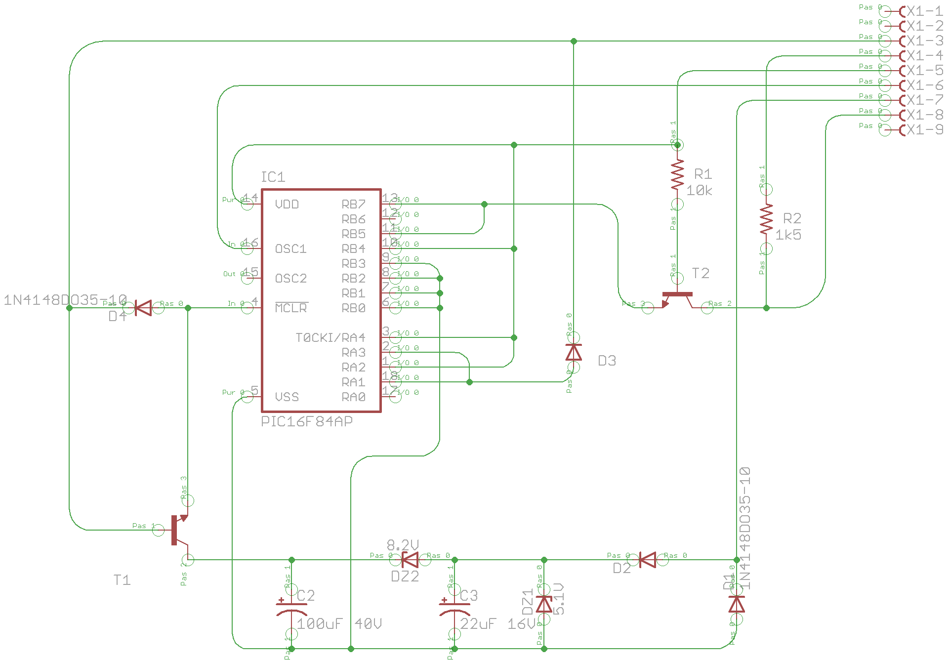

The project I chose is a JDM Serial PIC Programmer… (JDM stands for Jens Dyekjaer Madsen) which I found here :
http://webspace.webring.com/people/jl/leon_heller/pic.html
And which the author found here :
He substituted the 25 pin connector with a 9 pin connector ( DB25 – DB9 … RS-232) .. I like the DB9 more.
I worked with the schematic from the original page. Have in mind though that pins like TxD (2) or GND (7) refer to the DB25 Pinout, while I’m going to do a DB9 version.
To get the corresponding pins in a DB9, you can search for something like « RS232 pinout » or « DB9 pinout » or something like that..
Anyway … Here are schematics I did…
Serial JDM PIC Programmer_Rev1.4.png (Notice how angles are « rounded », it’s called « Mitering », there’s a button for it on the left)

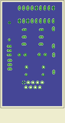

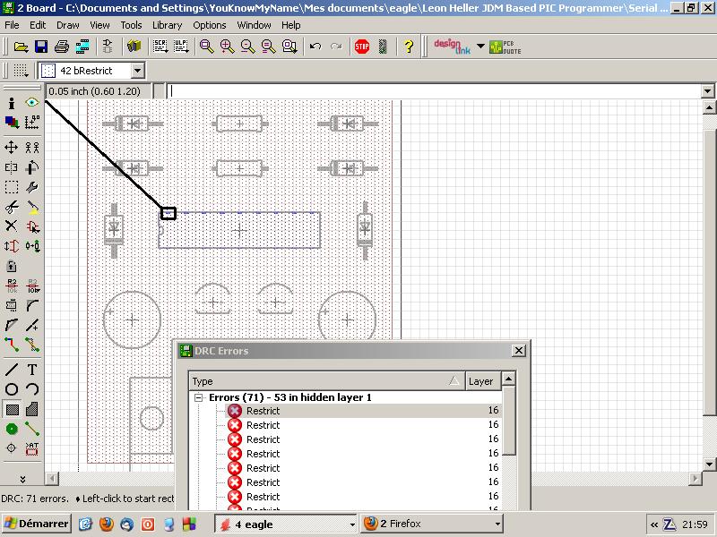

Here’s ultimately the « Board », revision 4… The file named "General.png". Not all layers are displayed here.

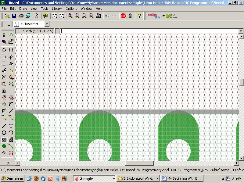

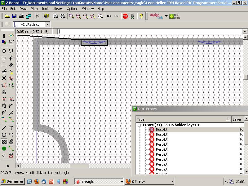

I drew a rectangle on the whole surface on vRestrict, I didn’t want any Vias in there. I’m a beginner, so I didn’t want to do that yet.
I drew two small rectangles under the PIC on two layers tRestrict and bRestrict, they’re a match. I didn’t want any routing under the PIC, because I thought it would better (Less heat influencing its functionning, and I wanted to diminish the influence of a field that would be created by the the current in a hypothetical route.)

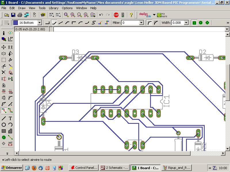

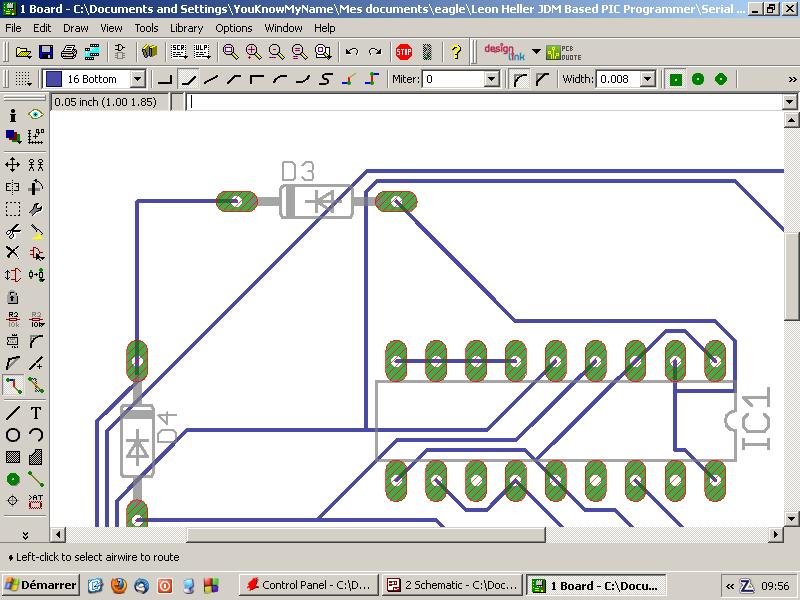

I had a problem as shown in the image, where these rectangles crossed over the pads, and it showed errors when I hit DRC (Design Rules Check).
I couldn’t draw accurate enough rectangles to include the whole chip, so I increased the Grid resolution by chosing 5 mils in « Size ». I could draw more my rectangles with more precision.
I think I managed to have a single sided board before (drawing a rectangle in tRestrict that included the whole surface), but NOT with that disposition. This one is very symmetrical as you can see here :
Not very big board, 1.8’’ by 2.135’’.
My questions are :
1. Concerning the schematic : Are there guidelines or Good practice rules or something ? I know I can make Non visually connected components to make things « neat », but as long as it’s not complicated, I prefer to « see » the flow of current and stuff… But anyhow, is there something that can be improved in the schematic ?
2. Am I thinking too much about the board ? Protecting the chip from stuff and all ?
3. I can do « Copper Pouring » for say Ground or in my case N $3 ‘because it’s used a lot ‘. I think that i twill spare some un-necessary etching and will save etchant (Less copper to etch, less molecules of etchant will be used, so quantity of etchant will last longer, etc)… How would these « planes » affect the functionning of the board practically…Any unliked capacitive effect or something ? How bad is it ?

Another question: I don't really like when routes pass under resistors or diodes, because these components lose accuracy with temperature. I can do restrictions under each resistor, etc... Is this too much ? I mean, some boards will eventually contain lots of components, and it will be more complicated to route, how can it be done ? Do I have to write some script that will draw a restricted area over each of these components ?
This is not a problem.

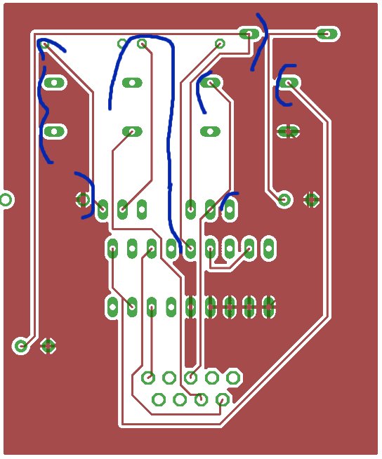

Copper Pouring is good. Ground and Power! Yes the capacitance goes up a little. For you simple circuit this not a problem.
On the copper fill, pin5, is an 'island'. Try moving the two traces around pin5 to the left 0.1 inch so pin5 connects to pin 6,7,8,9 better.
I marked places where you can move a trace and get the ground to flow into more areas. It is good to have more ground.

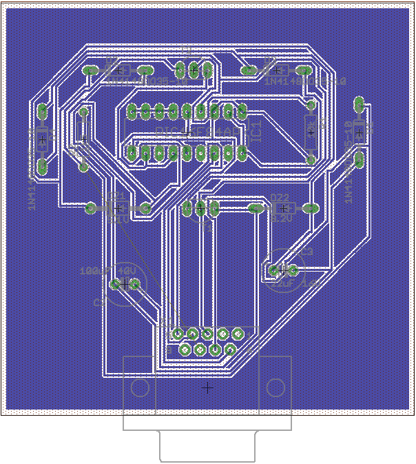

My bad, this was from revision 1.2 or 1.3 I think (Note how routes pass under the PIC, of which I restricted the area in revision 1.4).. Nonetheless, I couldn't figure out the meaning of what you wrote, I know it's for the copper to "flow" around and cover more aread, but I can't see the meaning of the traces you drew.
See attachement Revision.1.3.3_air_wires_corrected_Pads_Dimension_Bottom.
These are the Pads and Bottom layers (+Dimension) from Revision 1.3.
I had 3 wires that couldn't be routed and stayed as air-wires because I had put a rectangle in the tRestrict layer (I wanted a single sided board), and the software couldn't find a way to do it.
Notice how it is better looking, and I guess doesn't contain what I think you meant by an "island" (A rather big surface with copper around)
I chose the RS-232 GND as a signal for the polygon, instead of N$3 like in the picture I provided before.

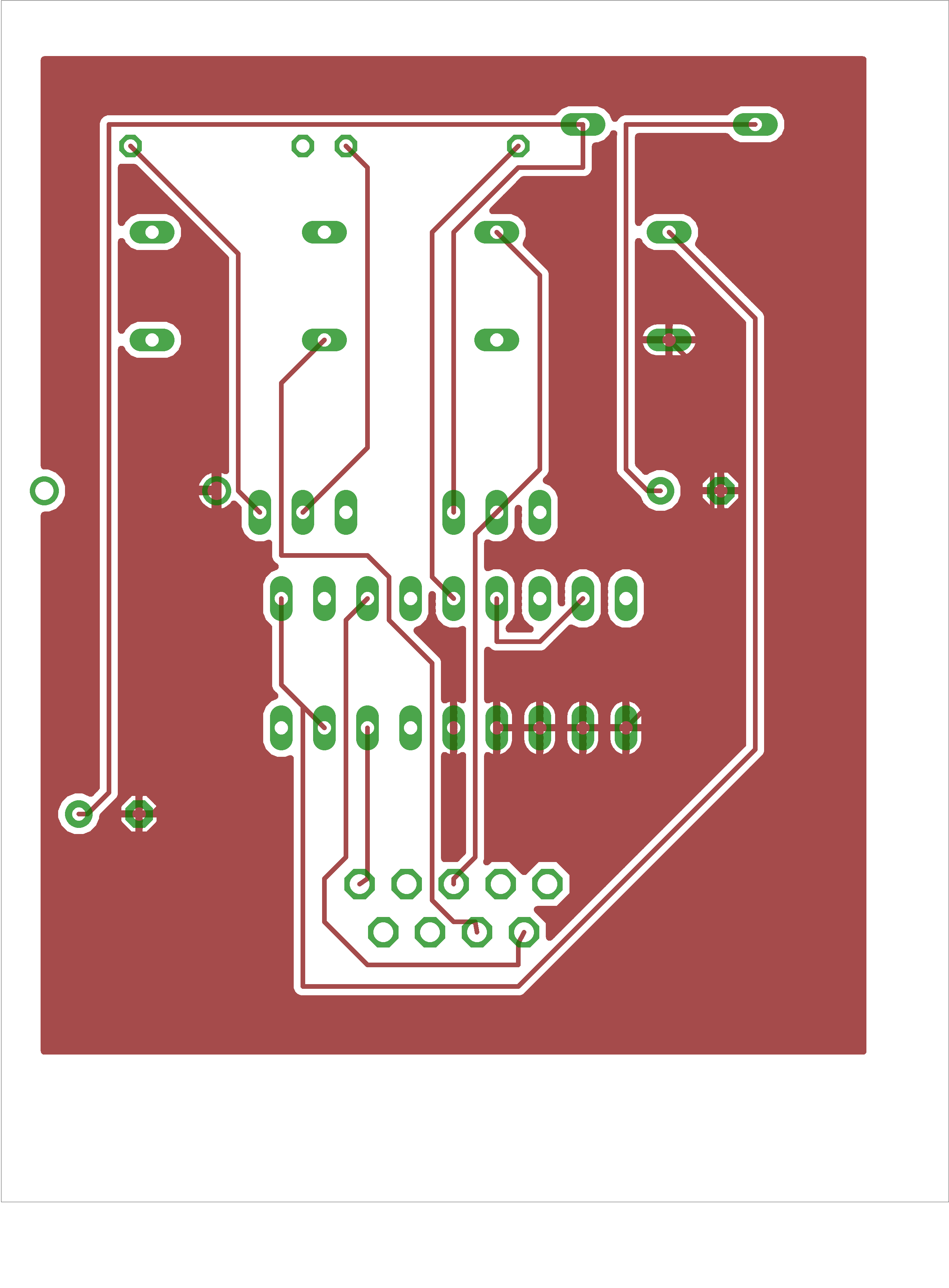

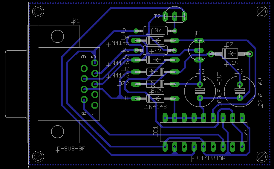

Hi Jugurtha,
here is my board design, one image with the copper traces and the other on including the ground pour.
Boncuk
Beauty and the Beast, man ! :D .. It looks really cute, and I notice that the board is less than twice the DB9 connector.. That's kind of small ..
I also notice there isn't a lot of wire length .. It's tiny..

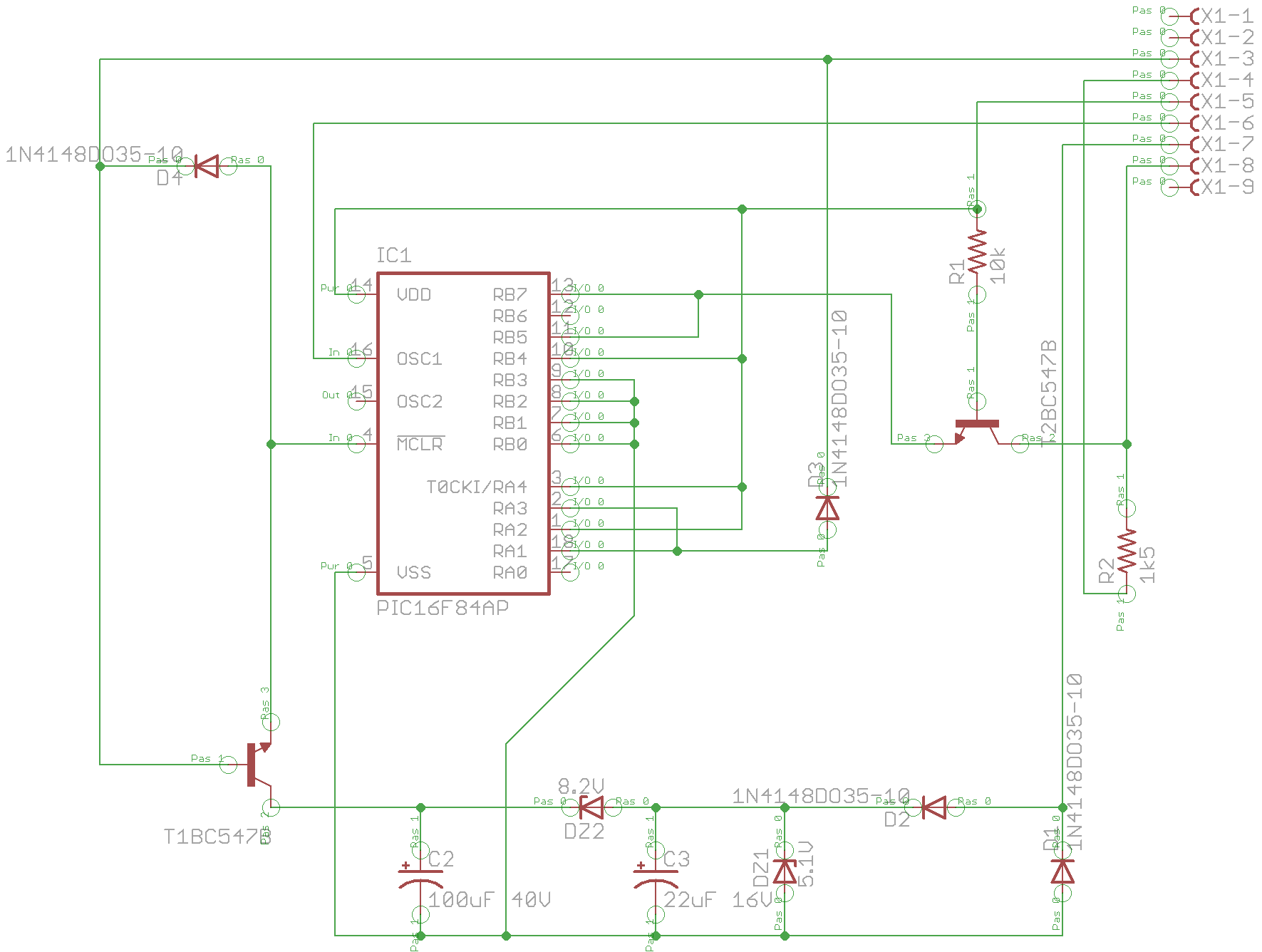

Meanwhile, I continued to work on my board, and something hit me, something embarrassing...
I started using the "SHOW" command/button more and more... And I was astonished following the signal, to see for example that a signal would go from DB9 pin6 all the way up to a component, then get out and make all the way down to pin7... It made no sens.. Why didn't I just put the component near the pins ? And it wasn't only one component that was like that..
So, I would get the component near the signals it served, and started optimizing a little bit.
First consequence: I managed to get single sided boards. Not only that, but it was possible to have single boards frequently.
If I didn't like something, I would imagine a better route and follow the signal (I did SHOW and I see) .. Then I arrange the component, and "ripup;" in the command window and hit Enter and then "auto;" and hit Enter. (Better than using the button in my experience).
Getting single sided boards was no more like a Halley thing, it was recurrent and it's reassuring. I'll keep improving the thing little by little, and hopefully get to do a beautiful thing like yours..
My questions regarding your design:
With which parameters did you route to get this ?
I notice when there's a junction between nets, yours is smoothed out, it's not a sharp junction.. How did you do that ?
How did you force your angles to all be 45 degrees incrementations ?
Is it okay if I do Copper Pouring for another signal than Ground ? You noticed that the N$8 is all over the place...

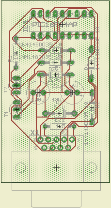

I joined the Rev.1.5 in the message here. I did copper pouring for the RS 232 GND signal:
Before routing, I put a rectangle on bRestrict layer covering the board. (To get a single sided board with routing on the Top layer and not touching the bottom layer)
Autoroute. Got a single sided board.
Removed the bRestrict rectangle from the board.
Drew a polygon in the Bottom layer (16)
Renamed the polygon as the GND signal.
Hit Ratsnet. Got a HUGE copper pour with some thermal pads/connections.
I didn't use any parameters. Every trace is routed manually using a grid size of 0.3175mm
I already described it in a former reply. (#7)
Sometimes you can't avoid an acute angle when a straight trace is being intercepted (for a junction) at 90 degrees. Even that should be smoothened to make two 45 degree angles into the junction. It can be done using the same trace width drawing two small traces using "wire".
But here it's again:
Use the same grid size you used for routing. Select the layer you want to draw on, then select "wire" (just below "route") and draw two wires onto the junction using the same trace width as you used for the original trace.
Being able to read is not a disadvantage. :p
Simply click the R/H mouse button until you get traces at an angle of 45degrees.

Why should a single signal have priority over circuit ground?
Why do you overcomplicate a thing like a ground pour? Just switch to "bottom" (in that case) and draw a polygon of 0.254mm around the board. Hit "ratsnest" and you're done.
Also try to avoid long names like this: SYSTEM_RS_232_GND. If you get a typo when naming the polygon you won't get the proper ground pour. Just call it SYSGND.
Regards
Boncuk
P.S. A schematic is not a knitting or sewing pattern. Kick out all your curved bends and replace them with 90 degree angles. Make sure the net names won't be changed. If they do it will mess up your board design.
