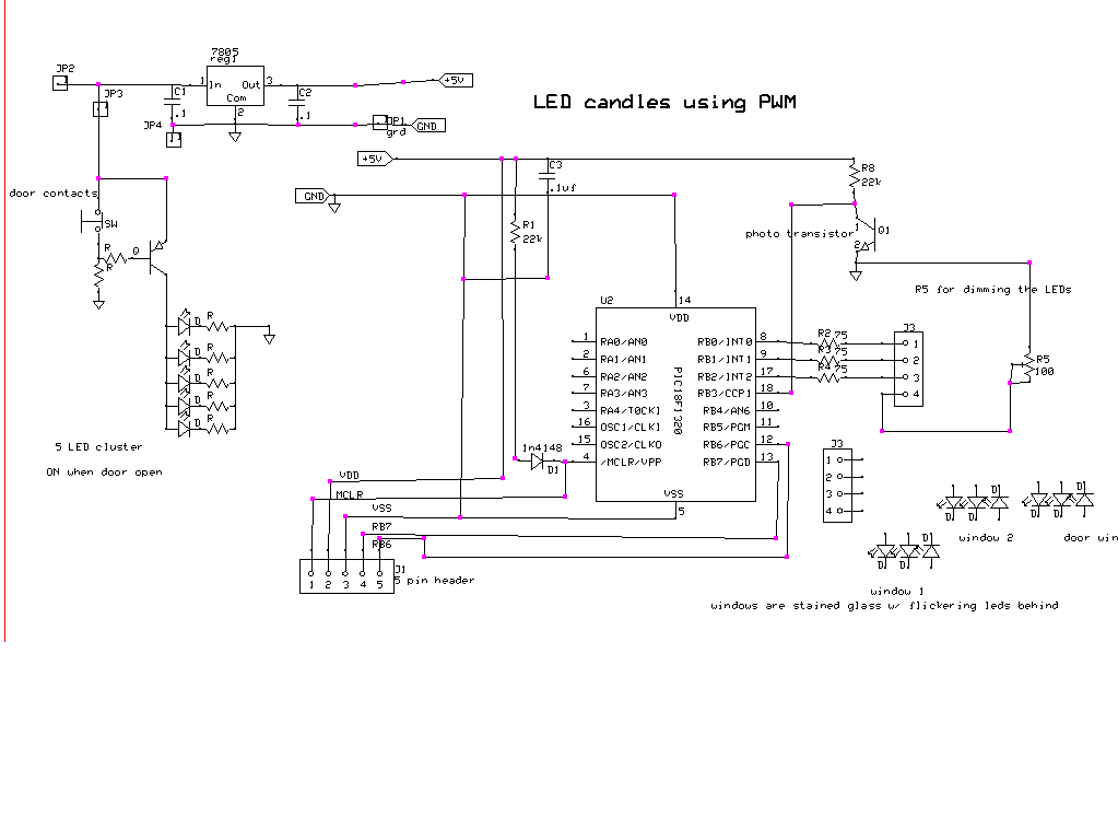

MrDEB

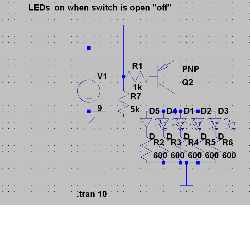

SETUP= using two contacts in a door . When door opens, the contacts open then the 5 LEDs come ON
AND the PWM circuit shuts OFF
thinking just add an NPN to control the PWM circuit.
will draw up a better diagram if need be but somehow this circuit I posted dosn't look right or stable??
Depends on your criterion for "better". if you want simpler, just have the door switch apply power to the LEDs or shunt the LEDs so they see no current.

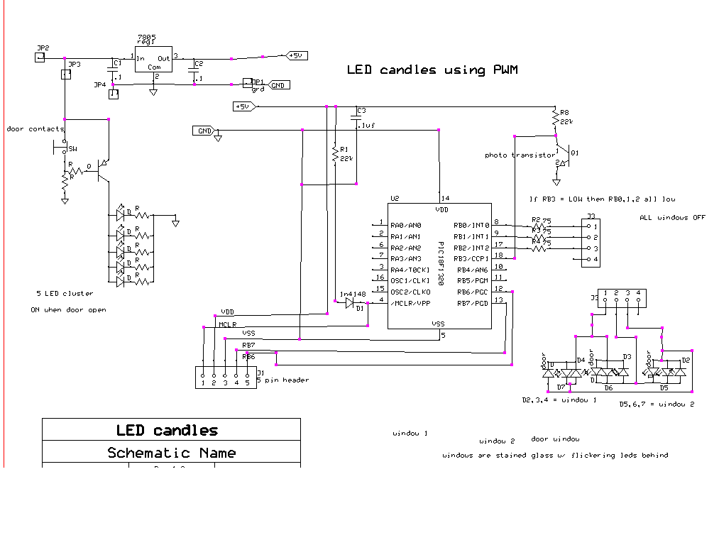

maybe this will be a better description

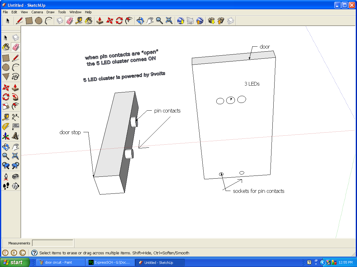

door layout and schematic but only have two wires in door but can maybe use the door hinge as third conductor then maybe chariplex the LEDs in the door as the other two windows have 4 wires but can I use PWM controlling 3 LEDs with ONLY 3 wires? need to think on this but suggestions welcome.
this is for a tabernacle I am building for a friend/parishioner.
SETUP - two stationary stained glass windows and one stained glass window in the door.
Behind the windows are three LEDs that flicker using a PIC/PWM.
The ceiling or top inside of tabernacle has 5 bright LEDs with 470 ohm resistors on each (all wired together in parallel see schematic)
when door is opened the inside LEDs come on
The window LEDs come on when the photo transistor "sees dark"
charlexplexing leds
hope I got this right. Charilexplexing LEDs using PWM

Your description is much better now. Which LEDs are part of the door assembly and which parts are not on the door? (I suspect the three you are multiplexing are on the door, but am checking).
In my latest schematic I show 9 LEDs that are charliplexed. Dosn't really matter (?) as long as I have three. Thinking one from each groupe of three.
In the schematic I have window 1, window2 and door marked on the LEDs.
Slight change - may have to ADD a micro switch to the door lock to control the 5 cluster LEDs as the door contacts are used to power the door LEDs.
