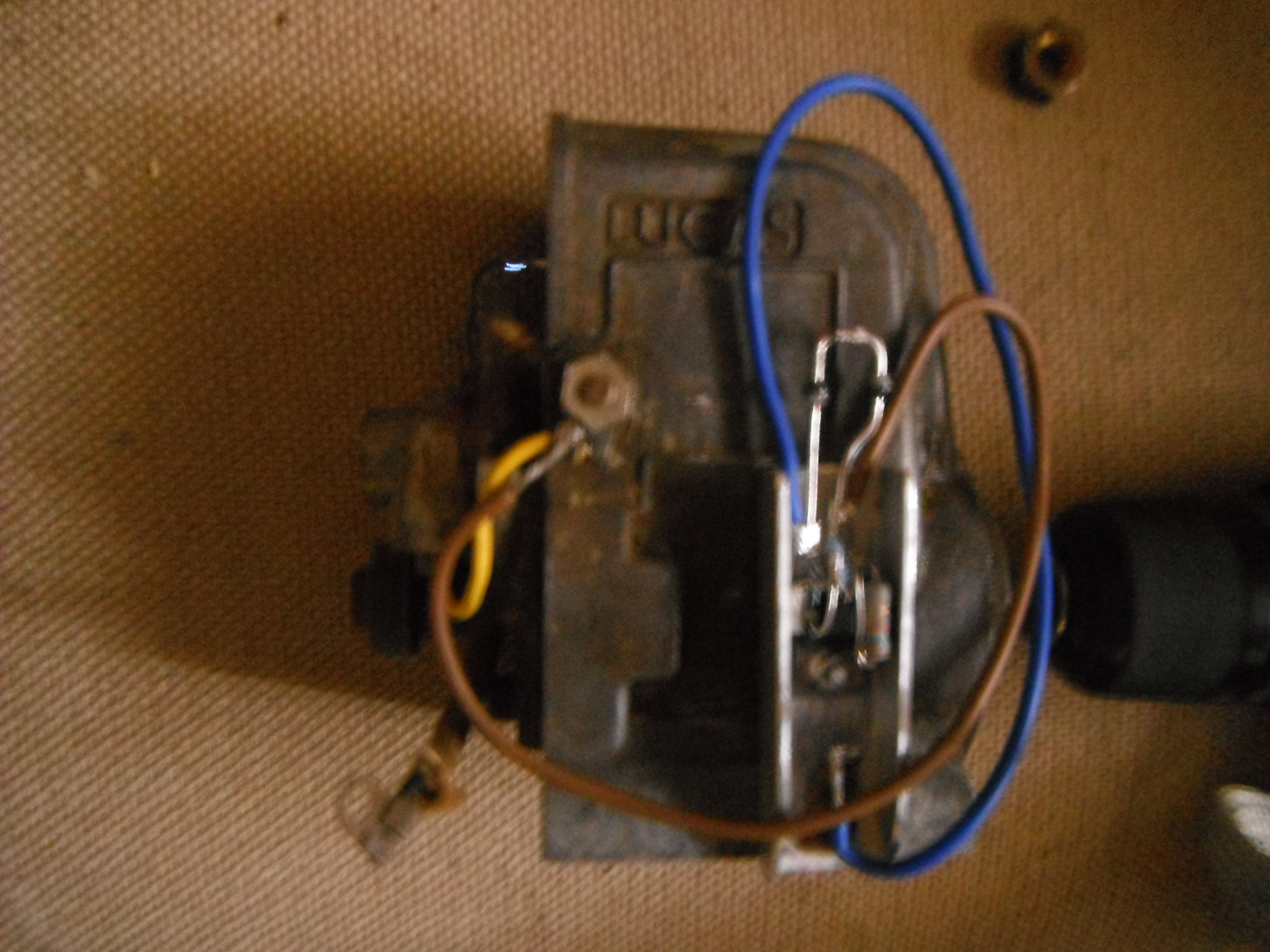

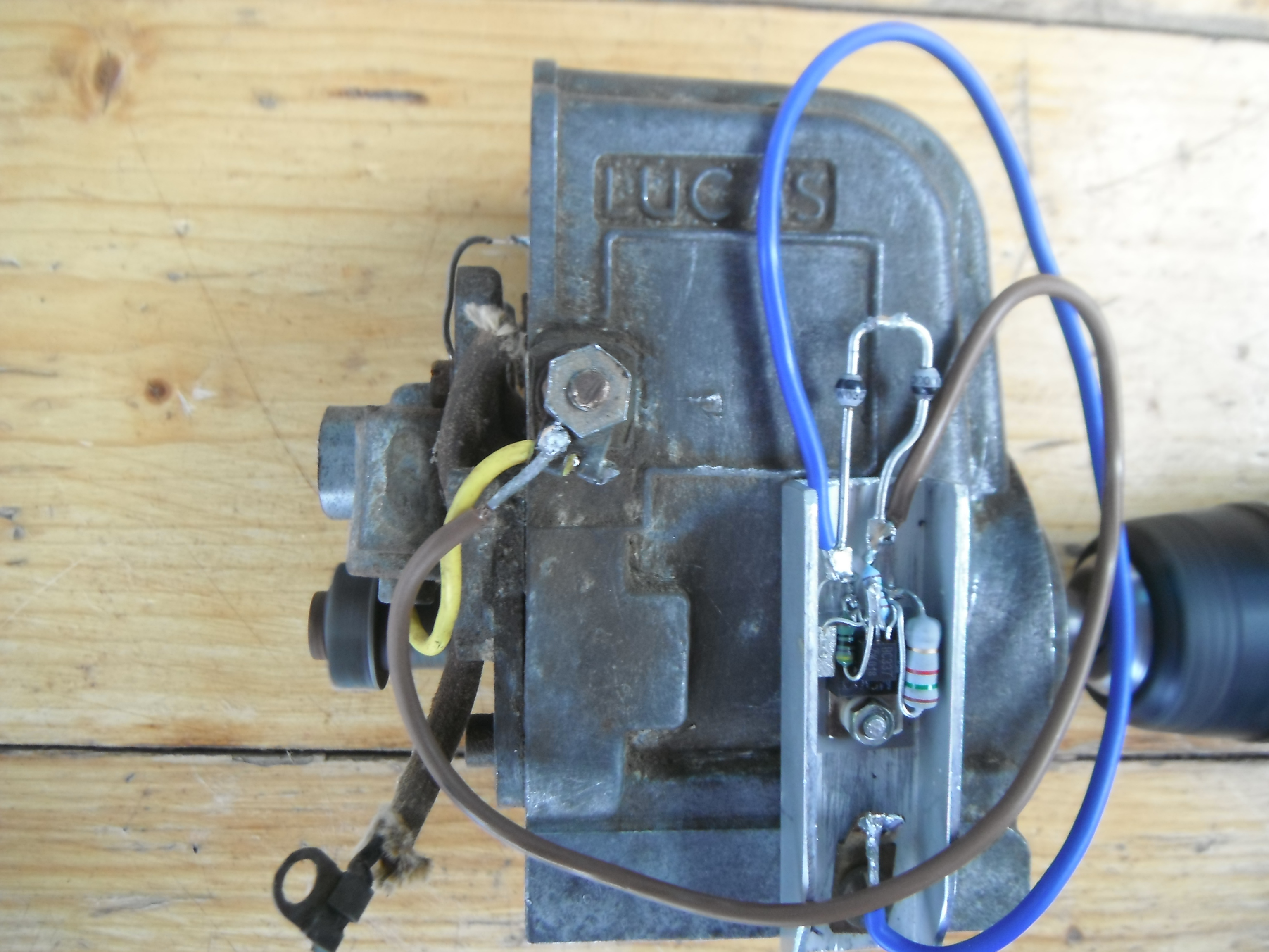

The other thing is to just use a common 12 volt ignition coil and use the points inside the magneto to trigger it. Personally I find that the most easy conversion to work with.

Another alternative if the coil is still good in the magneto. Use either an Atom IGN module or NOVA 11 IGN modules to replace the points & condencer. The picture is a Lucas SR magneto with a copy of an Atom module on it.
