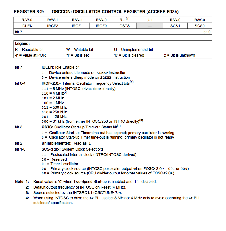

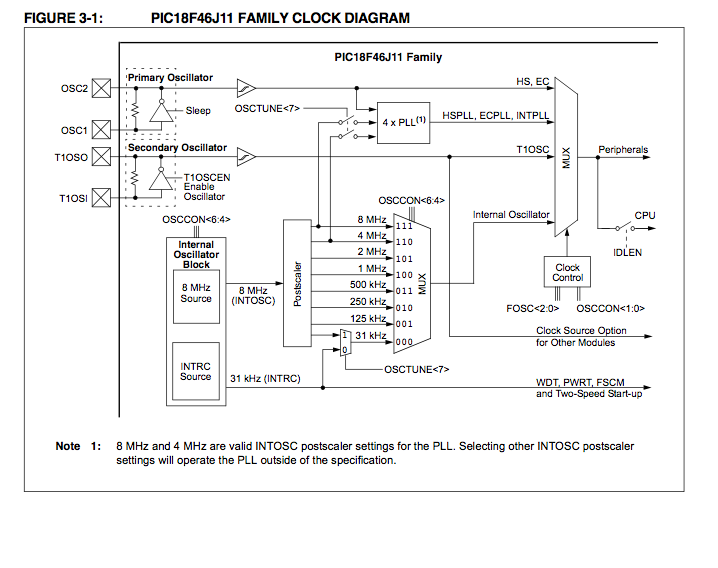

i am trying to set the oscillator value of my PIC18f26j11, but am running into much difficulty.
Trying to set an 8MHz value is problematic, i have:
chosen the oscillator to be INTOSC
set the literal '01111100' to osccon
as instructed in the data sheet but any delay sequence i implement, even those created using online delay generators last for less than a second. is there something im missing
