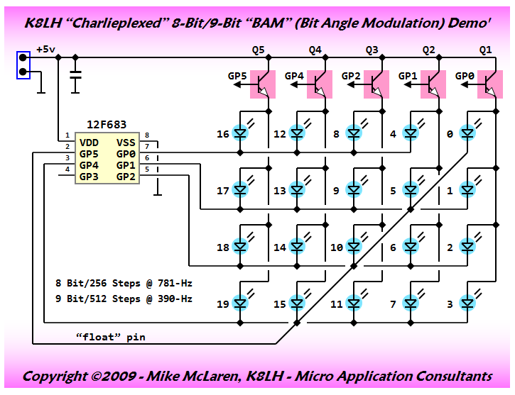

Well I think those are absolutely excellent Charlieplexed matrix applications. Since you're only lighting a set number of LEDs at any given time you can increase duty cycle, average current, and brightness dramatically simply by using a carefully designed driver. Nicely done.

Hi Mike, the most LEDs I have attempted to appear to be lit at once - of course they simply cycle very fast - is 39. This is in a 7 segment display clock made out of individually addressable LEDs. I am very happy with the result, I get no visible flicker or changes in apparent brightness. It's rock-steady and very bright indeed.

I admit I cheat and use column driver transistors to increase duty cycle. For example, here's a Charlieplexed matrix of 20 LEDs with a 781-Hz refresh rate (8 MHz clock) and 20% maximum duty cycle per LED. Each LED is adjustable to 64 gamma corrected brightness levels spanning 256 PWM steps (1-usec steps) for smooth fade capability. In the video below, the LEDs in the left column are lighted for 1 usec (top) to 10 usecs (bottom) out of each 1280 usec period. Unfortunately, the LED wavelength is such that it overloads and saturates the camera and picture quality suffers accordingly.
