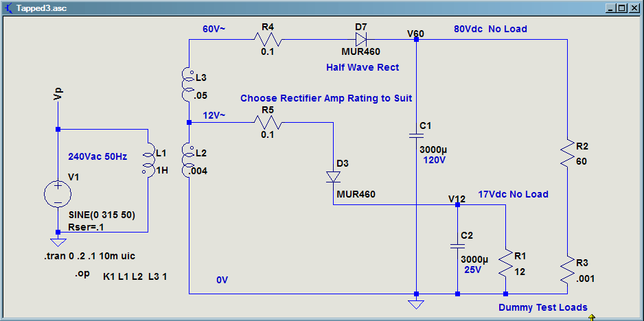

RCinFLA is correct. With a tapped winding that you have, all of the other suggested configurations are wrong. You have confirmed this with explosions and smoke.
You have two choices:
2) Continue to call your 0V terminal "0V". Develop each of the two necessary voltages with a half wave rectifier (single diode) and capacitor. This isn't a good idea at the current levels involved.
In either case, you should use properly rated diodes. 1N4007s are only good for about 1A. You should consider 25A bridges for 10A; if your co-workers or local merchant don't know some, come back and we'll try to help.
hi,:)
This halfwave suggestion was made earlier.
Looking at the overall dimensions and the wire gauge I dont believe that this transformer is rated for 10A at 60V..
The reason for the cap blowing up IMO, was because the OP was using 1A diodes in a 10A application and I suspect the 1N4007 went short circuit and applied 60V ac across the cap.
EDIT: just seen your edit.;)
It does seem to be a pretty small transformer for 600VA. :confused:
Especially when the end winding is 110V.!
Makes it about 1KVA, I suspect the lower voltage winding of 12V~ is 10A and the higher taps are much less in current rating.
an Update..
The solution was simple... infact too simple. I checked the transformer and it had indepenadnt windings which were connected in series to give the desired voltages.
I seperated the 0-12 coil and thus created another 0 for the 0-98 winding..
Now I have a transformer that has two seperate secondary windings 0-12 and 0-98 with 0-98 being multi tapped. giving me 58 instead of 60V which is perfectly acceptable.
I tried joining the common for both supplies after rectification and filtering and it worked well. and it gave me two supplies with a common ground!..
Thank You for all your kind help and patience witha noob like me..
Cheers all.
