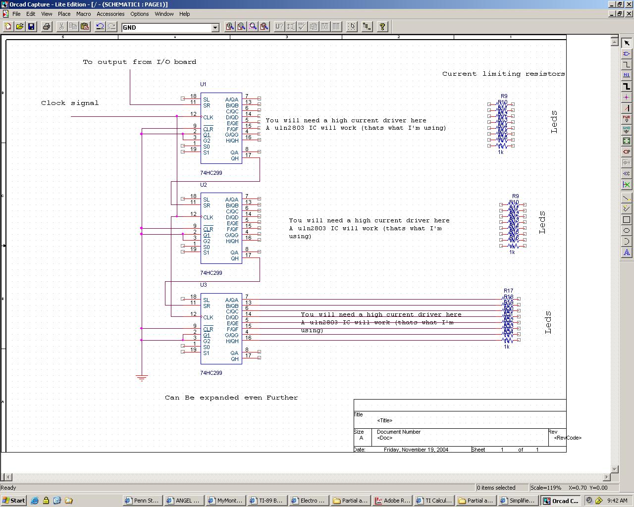

My professor is asking me to find a schematic diagram of a MULTI-ARRAY LED DISPLAY MODULE and build it. It will be connected to an I/O interface module which I already have. The display module must be controlled by the I/O interface.The diagram can be found at **broken link removed**. Pls. give me some tips on how to build a multi array LED display module and where I can find the schematic diagram. Thanks :p

Anyhoo, shift registers are what you need, I'm currently working on a similar project, only I'm going to use a micro to control the I/O
You shift the bits in at high speed, that is, you send the bits into the SR one at a time, this speed is determined by the clock signal. there are 8 bits per register so once you shift the 9th bit in, it is carried over to the next SR. (Sorry if I confused you, I gotta run to class, maybe someone else can explain it more or they have a better schematic)
heres a quick schematic
